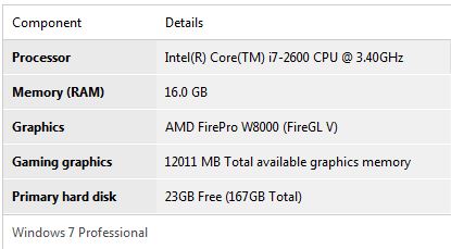

CADMASTER1128 Posted January 27, 2014 Author Posted January 27, 2014 Real funny ReMark... I was just curious because of how my computer performs at the office. Slow, buggy, Fatal Errors and hates Hatching, XREF and PDF Underlay... Switching tabs is also laggy... I have those specs below, running ACAD 2013 Vanilla Quote

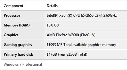

CADMASTER1128 Posted January 27, 2014 Author Posted January 27, 2014 Just because your i7 at the office runs poorly is no reason not to consider an i7 for your laptop. There could be plenty of reasons for the poor performance. What has been done to troubleshoot the problems? We have contacted our IT department and they don't know what to do... I have searched for CADTutor for solutions... I am trying to balance that and getting my work done (and training the new designers) I just looked at my co-workers computer (who has the latest and greatest) and tried to hatch an area and that Frozen up her computer... I have attached her specs below... Quote

SLW210 Posted January 27, 2014 Posted January 27, 2014 I've never been a fan of AMD graphics cards. I would check around and see if others have had problems with that card or driver in AutoCAD. Quote

RobDraw Posted January 27, 2014 Posted January 27, 2014 Your hard drive is quite full. Getting more free space might speed things up. Quote

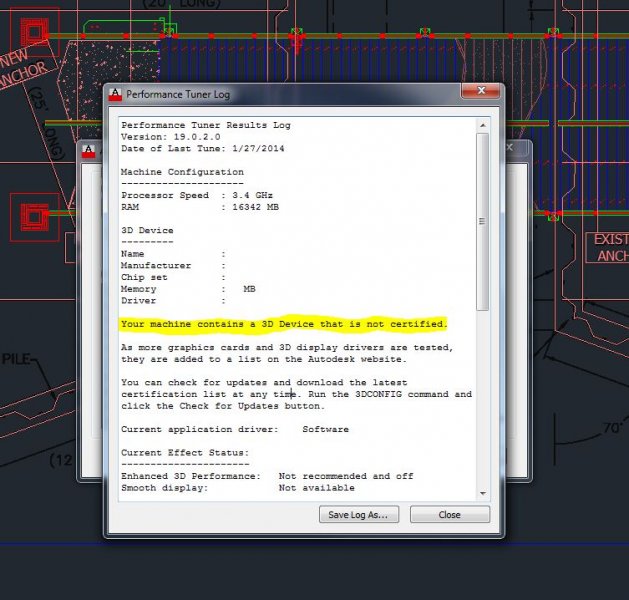

ReMark Posted January 27, 2014 Posted January 27, 2014 Posted over at blog nauseam: If your hatching performance is poor, have you tried changing the values of system variables to turn off features to see if the problems persist? Try HPQUICKPREVIEW = 0, HPDLGMODE = 1 and SELECTIONPREVIEW = 0. Also, if you are having display performance issues, try VTENABLE =0 and check using 3DCONFIG to see if your graphics card/driver combination is certified. Quote
CADMASTER1128 Posted January 27, 2014 Author Posted January 27, 2014 Great tips and I adjusted my settings. I will let you know how that does. check using 3DCONFIG to see if your graphics card/driver combination is certified.[/i] Now this is interesting.... http://usa.autodesk.com/adsk/servlet/syscert/card?siteID=123112&catID=18254205&id=18844534&product=56&os=8192&hw=268 Quote

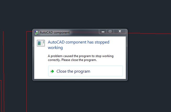

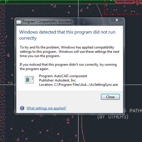

CADMASTER1128 Posted January 27, 2014 Author Posted January 27, 2014 I did go through the settings but now "An AutoCAD component is failing" Quote
