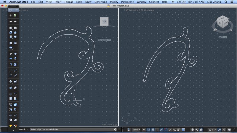

For some reason I can't extrude this polyline. I'd drawn it as a bunch of splines at first, but then I found out that they weren't joined together. I traced over all the individual splines with one spline, and then deleted everything underneath. It still won't extrude. Can anyone tell me why? I tried a bunch of things--pedit, joining, etc. Nothing.
When I click 'extrude,' the command thing says 'select objects to extrude or [MOde]:'. I clicked my spline and it highlighted, and then I hit enter. The message doesn't change.
Any suggestions?

Something is still off, though. It's definitely closed--when I used pedit, the only option was 'open.' just to make sure, I used the pedit function to open it, and then close it again. I also tried press-pulling. Same problem; the command said to select objects, I did, the command didn't change. Just to make sure, I extruded a random 2d polygon I made, and it worked fine. Then I presspulled one. Same thing, it worked.
I know this is a strange question, and I don't think it's the factor, but is it maybe because the shape is too complex? it's not that bad--it's one of the handles of a chandelier, but when I use certain commands on it my computer freezes up. Right now, there's a spinning beach ball on my screen.
What do you think? What do I do?

I also tried press-pulling. ....the command said to select objects, I did, the command didn't change. ... maybe because the shape is too complex?
No, the presspull command prompts to select object OR area. Because you selected object and it didn't work - I'm betting a self-intersecting curve.
Attach your dwg file here and end all doubt. (For the life of me, I can't figure out why so many ask questions without providing enough information. At least a screen capture. And if a picture is worth a thousand typed words, the actual geometry might be worth a thousand pictures. Attach the dwg here.)

Yeah, I figured I should've attached a screenshot from the start, but the upload manager thing wasn't working for me :/ sorry.
But I think you're right that it's a polyline that overlaps itself; that might be the problem.

I could see where you might experience a problem near the bottom of your profile where it rolls back on itself like JDM mentioned.
... a polyline that overlaps itself; that might be the problem.
I can see 4 areas that don't make logical sense to me.
Yep, each of those curly q's is a no-go.
I agree with JD and Patrick. The splines/arcs that are inside the boundary that you're trying to extrude are the problem. I worked on a file that was supposed to mimic hand-carved wood (which is the impression that I get from this) that we cut on our CNC and it came out OK, so I might have a few pointers for you but it won't look as pretty, or be as easy, as you're probably hoping for.
Extruding a pline from a spline is a hit and miss, personally I never use splines unless I modify a pline and that can still cause problems. I have seen in responses above a couple of things to consider. 1st "Can a spline/pline be too complicated" answer Yes. Now my wording may be incorrect but after 25 years doing 3D on autocad I ask for some leeway. A spline is not really an object or at least it doesn't seem to act as one. I receive a lot of ship and barge models and they seem to be huge fans of splines even though a properly made pline does the job better and is more workable and when you extrude a spline you do not get solids but regions. This is again why I say it is not a real object. 2nd one of the problems with a closed spline is the high likely hood that it will have a self intersecting curve which will not allow the functions you are trying. Solution: Draw a pline over the top of your spline with as many points as you would like when finished close the pline and extrude. Guarantied to work, unless you make a self intersecting curve.
