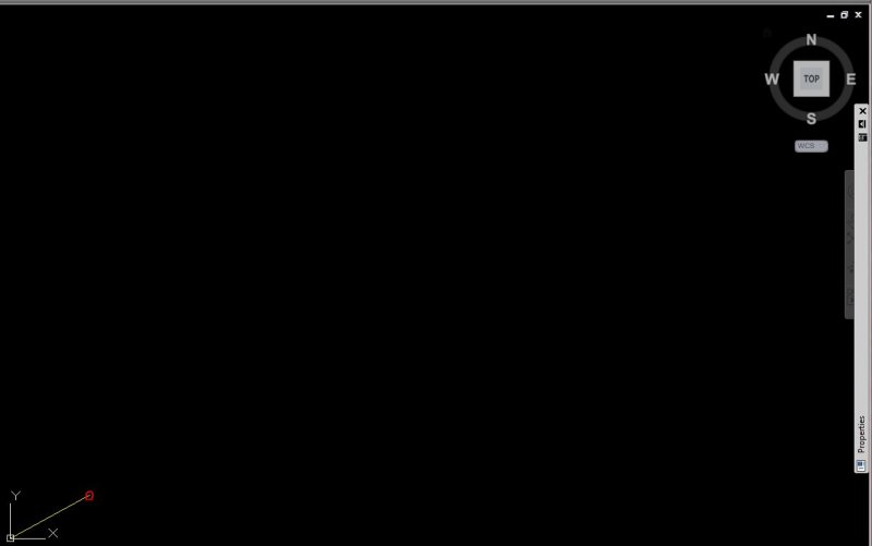

ReMark Posted January 24, 2014 Posted January 24, 2014 I'm back. This is what I would like you to do Nocrow. It is very simple. We are going to draw a line between two points. The first point is 0,0 and the second one is the center of the benchmark at the northeast corner of SW Washington Street and SW Oleson Road. Then we are going to zoom in on the benchmark. Follow the prompts below to draw the line. LINE Specify first point: 0,0 Specify next point or [undo]: 1421334.93,783207.62 (these are the coordinates for the center of the benchmark) Specify next point or [undo]: Command: Z (for Zoom) ZOOM Specify corner of window, enter a scale factor (nX or nXP), or [All/Center/Dynamic/Extents/Previous/Scale/Window/Object] : W (W is for "Window") Specify first corner: Specify opposite corner: Command: Z (repeat as necessary to see your drawing) STOP! Don't do anything else. Come back here and let us know if your finally found your drawing. Quote
ReMark Posted January 24, 2014 Posted January 24, 2014 This is what I see on my screen when zoomed to the limits Penn-Foster recommends students use for the Oleson Village project. I have drawn a line from 0,0 to the center of the benchmark. Oleson Village is inside the red circle. See it? Reminds me of the old TV program Lost In Space. Just to refresh your memory these are the project limits: Command: limits Reset Model space limits: Specify lower left corner or [ON/OFF] : Specify upper right corner : That's right...10 million, 10 million. These are the coordinates (lower left hand corner, upper right hand corner) of the actual village itself. ....from point, X=1420531.09 Y=783074.00 Z= 0.00 ....to point, X=1422256.09 Y=784093.89 Z= 0.00 Compare these coordinates to those shown above. I told one of the instructors over at Penn-Foster they should reconsider changing the coordinates defining the upper right hand corner of the project limits to something smaller but I guess they did not follow my advice. Quote
