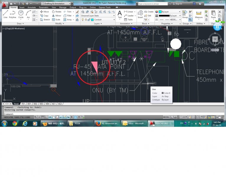

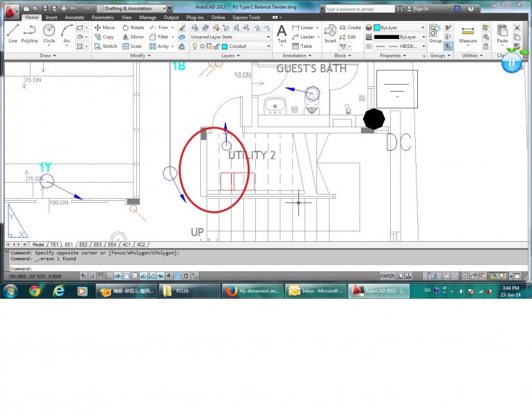

Some of the layers appear in model but missing in layout?
May i know why some of the layers appear in model but missing in my layout drawing ? Is it had been frozen ? How can i unfreeze it ?!
Thank !
Please go in Layout tab, activate the viewport where the information is missing and in layers pop-up list check that there was enabled another option: Freeze or Thaw in current viewport.
