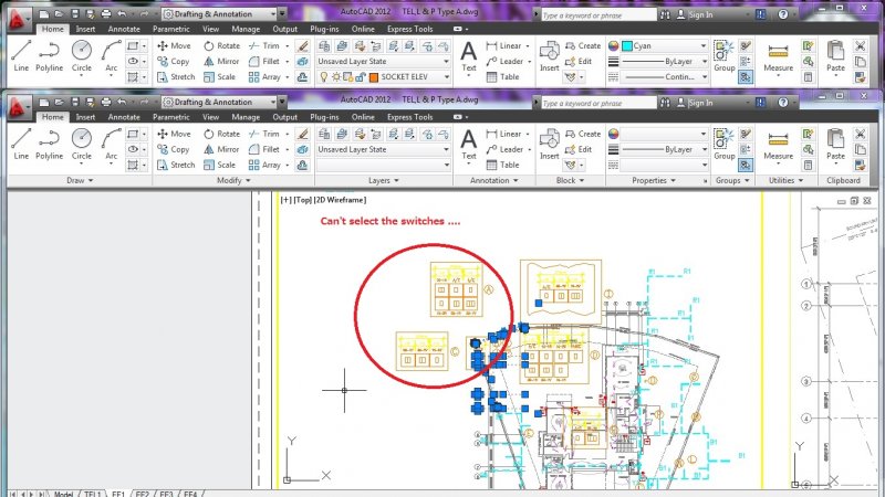

Hey guys , may i know how to select or delete the unwanted switches in my layout drawing ? I can select it ... may i know what layer is that and it doesn't appear in my model drawing...

It looks like you have two viewports over the top of one another. Move a viewport to see if that is the case.

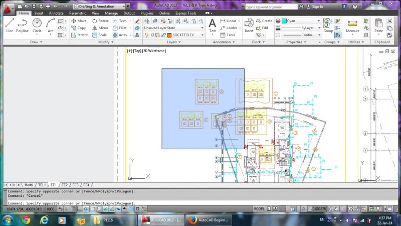

looking at the 2 images the only items selected fall within your selection window, at a guess I would say the switches are part of a larger block or group. Which direction do you make your selection window, I would imagine left to right, which means only objects fully contained in that window are selected, whereas if you select right to left then any objects in or crossing the selection area are included.
Bro...solved already... delete the viewport first then can select all the switches already ! Thank all !
