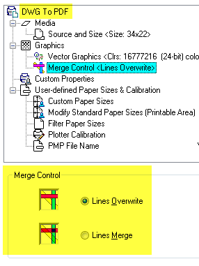

rkmcswain Posted January 22, 2014 Posted January 22, 2014 Dear friends, I tried.....DWGtoPDF. .... Did you check/change the options inside the DWG to PDF.pc3 driver? Quote

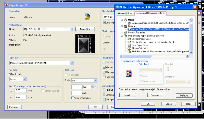

Marco1979 Posted January 22, 2014 Author Posted January 22, 2014 in my dwg to pdf there isnt an option Merge control. Did it plot ok with you? With a lot of other drivers i CAN set this....but even if i set it to merge lines, it still keeps putting them in front of the other. Quote

Spaj Posted February 19, 2014 Posted February 19, 2014 I think one of the replies may have been mine. Don't know what happen to it... In your screen shot (post #7) where you illustrate the option is missing the plotter is shown as 'PDF - PDF Plot - by Autodesk'. The PDF driver in recent versions of AutoCAD is 'DWG to PDF - PDF ePlot - by Autodesk' which has the merge control mentioned by rkmcswain. I'm not familiar with ACAD2009 but see if you do not have the option to install this driver rather (Plotter Manger/Add-A-Plotter Wizard/Autodesk ePlot (PDF). Quote
eldon Posted February 19, 2014 Posted February 19, 2014 What version of TrueView do you have installed? versions 2010 and 2013 both have the Merge control. Quote
