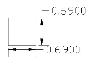

gotchy Posted January 18, 2014 Posted January 18, 2014 I'm not sure that this problem has anything to do with Autocad, or maybe my Video settings or adaptor, but I get an awful distortion of geometric drawings on my monitor, and yet the objects print out correctly. for example a perfect circle shows up as an elipse and enclosed is what a perfect square looks like. Thanking you in advance is, Gotchy Quote

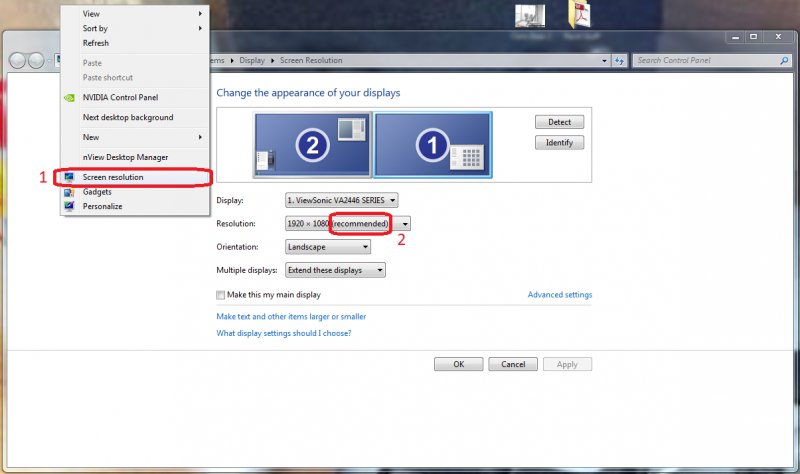

tzframpton Posted January 19, 2014 Posted January 19, 2014 Looks square to me. Make sure your monitor resolution is set to it's native resolution. This gives the best results. If not, things can be skewed quite easily since pixels are being stretched and squished to "fit" the monitor. Quote

gotchy Posted January 20, 2014 Author Posted January 20, 2014 If anyone knows the Autocad command to change the screen X Y, I would appreciate their sharing it with me, I was shocked to read that the screen shot that I submitted looked "square" too tzframpton, until I looked at it on another monitor, and it is indeed square, sir. In reality, on the monitor in question it looks like a rectangle whose height is 35-40% higher than it's width. That's how badly the axes are off. Thank you, Gotchy Quote
Dana W Posted January 20, 2014 Posted January 20, 2014 If anyone knows the Autocad command to change the screen X Y, I would appreciate their sharing it with me, I was shocked to read that the screen shot that I submitted looked "square" too tzframpton, until I looked at it on another monitor, and it is indeed square, sir. In reality, on the monitor in question it looks like a rectangle whose height is 35-40% higher than it's width. That's how badly the axes are off.Thank you, Gotchy Is this a new monitor or computer, or a new installation? Do you share computers? If it looks square on other monitors, including mine then it is as mentioned before, your monitor resolution/screen settings are off, it probably has nothing to do with AutoCad. See your IT department, or look for your display settings/advanced settings in Windows Control Panel. Maybe someone has decreased the screen resolution from "Native" to make web pages fill the screen better. Quote
SLW210 Posted January 20, 2014 Posted January 20, 2014 What monitor do you have and what is your current resolution? The monitor listed in your computer details has 1,600x900 as recommended. Quote
RobDraw Posted January 20, 2014 Posted January 20, 2014 To check/adjust your screen resolution right click on your desktop, click "Screen Resolution" then change it to the "Recommended" setting. Quote

RobDraw Posted January 20, 2014 Posted January 20, 2014 You do have it. Try this: http://bit.ly/1jpZjZD Quote

mikekmx Posted January 22, 2014 Posted January 22, 2014 For the people at the back................ Windows XP Professional Product Documentation > Customizing your computer To change your screen resolution 1. Open Display in Control Panel. 2. On the Settings tab, under Screen resolution, drag the slider, and then click Apply. 3. When prompted to apply the settings, click OK. Your screen will turn black for a moment. 4. Once your screen resolution changes, you have 15 seconds to confirm the change. Click Yes to confirm the change; click No or do nothing to revert to your previous setting. Note •To open Display, click Start, click Control Panel, click Appearance and Themes, and then click Display. •A higher screen resolution reduces the size of items on your screen and increases the relative space on your desktop •You can switch your screen resolution temporarily to 640 X 480 if you have games or other programs that are set to run at that resolution. To switch, right-click the game or program (on the desktop or on the Start menu), and then click Properties. Click the Compatibility tab, and then select the Run in 640x480 screen resolution check box. Your display reverts to its default resolution when you close the program. •Your monitor and video adapter determine how much you can change your screen resolution. You may not be able to increase the resolution above a certain level. •Changes to screen resolution affect all users that log on to the computer. •Only the recommended screen resolutions are listed. For additional settings, click the Advanced button on the Settings tab, click the Adapter tab, and then click List all Modes. Select the resolution, color level, and refresh rate you want. Quote
