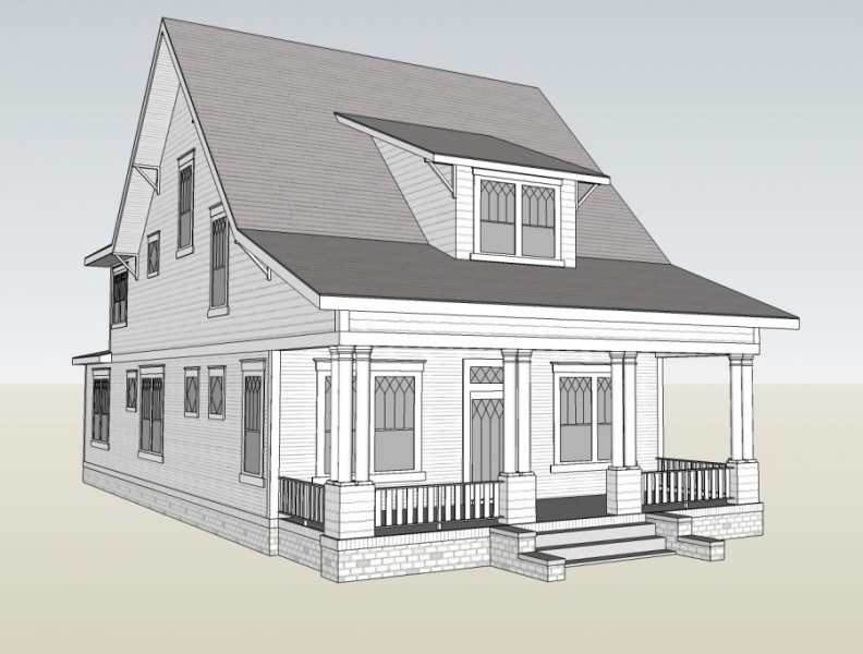

IMHO SketchUp would be a good solution for this. You said you only need a quick mock up and this is a good tool for this.
This is what I do with a plan and elevations...

Google Sketch up is a free download, very beginner friendly. There are quite a few tutorials on line for it.
Sorry been busy this weekend. The problem is that the current version of Sketchup does not allow dwg import but we can get around this. Download and install both the 2013 version as well as version 8. Use the 2013 version to bring in your plan and elevation dwgs. As soon as you have these in save the file as a version 8 copy then use version 8 to model you design. You only have 8 hours in the demo mode to import dwg files so use the 2013 version for this as it will not take but a minute. Then make your model in version 8. I'll try to get a picture up of how to set up your views to model.

Here is the typical setup I use. I align all views around the plan and start modeling using the elevations as guides...
