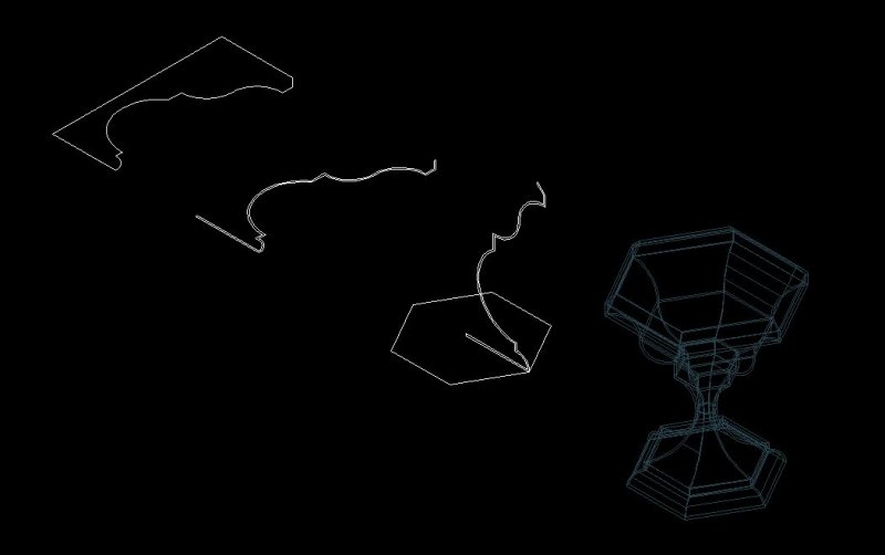

ReMark Posted January 18, 2014 Share Posted January 18, 2014 My rather hasty attempt yielded this. Keep in mind I had no dimensions to work with. The vase is a figment of my imagination. Visual style: Conceptual. I ended up creating a closed half-profile that I extruded using a hexagon as a path. This is just one way of doing it and not necessarily the best or fastest way. Please keep that in mind as other members suggest alternatives. Each user decides according to his/her own skills what method to use. Quote Link to comment Share on other sites More sharing options...
ReMark Posted January 18, 2014 Share Posted January 18, 2014 A view of all my model space objects both 2D and 3D. Visual style: 2Dwireframe Quote Link to comment Share on other sites More sharing options...

Dadgad Posted January 18, 2014 Share Posted January 18, 2014 [ATTACH=CONFIG]46381[/ATTACH]My rather hasty attempt yielded this. Keep in mind I had no dimensions to work with. The vase is a figment of my imagination. Visual style: Conceptual. I ended up creating a closed half-profile that I extruded using a hexagon as a path. This is just one way of doing it and not necessarily the best or fastest way. Please keep that in mind as other members suggest alternatives. Each user decides according to his/her own skills what method to use. Looks pretty good to me ReMark! Quote Link to comment Share on other sites More sharing options...
