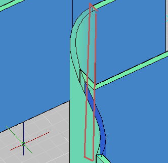

What I'd like to do is make a solid wall. The problem is that the wall is curved, so I drew it using splines, like so:
I tried extruding, but that just extrudes the splines, it doesn't make them a solid.
I don't know how to solve this, I'm not that familiar with autoCAD yet, but maybe there is a way to make the splines (part of) a polyline or something?

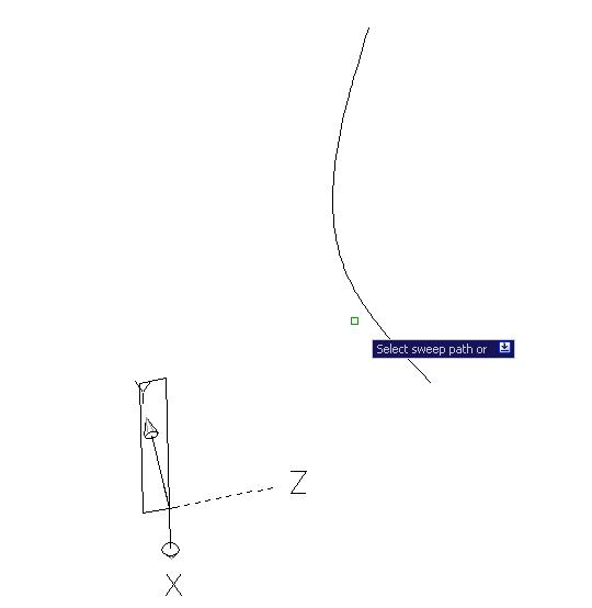

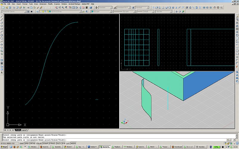

This seems like an excellent idea, thanks! But sweep doesn't seem to work.. when I try to sweep across the spline, it doesn't do anything and when I try to sweep across the extruded spline, it doesn't do anything either. It says
Select sweep path or [Alignment/Base point/Scale/Twist]:
The selected path curve is not valid.
Am I doing it wrong?

unfortunately i dont have 07 or newer at home so i cant try anything to help you out. I dont think you would be able to use your surface as a path but you should be able to use your spline. Is your rectangle a closed pline? have you used either region or pedit to join them? what if you draw a circle or some other shape at the end of your spline, will it let you sweep that?

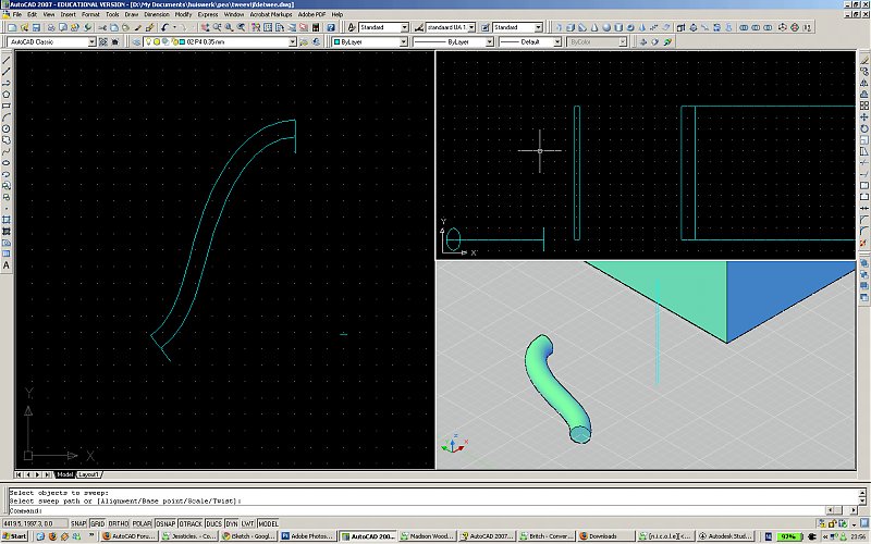

My rectangle is a rectangle, not a polyline. When I draw a circle and try to sweep the spline I get this.
By the way,I was thinking it was because the rectangle was away from the spline, but that wasn't it, either.
that is very odd. the same path allows the circle to sweep but not the rectangle. when you have the select path option, there is also Alignment/Base point/Scale/Twist. Type A, i believe it is a yes or no option for keeping the sketch perpendicular to the path. change that option and try again. Also type B for base point and select where you want your base point to be, top left of your rectangle.

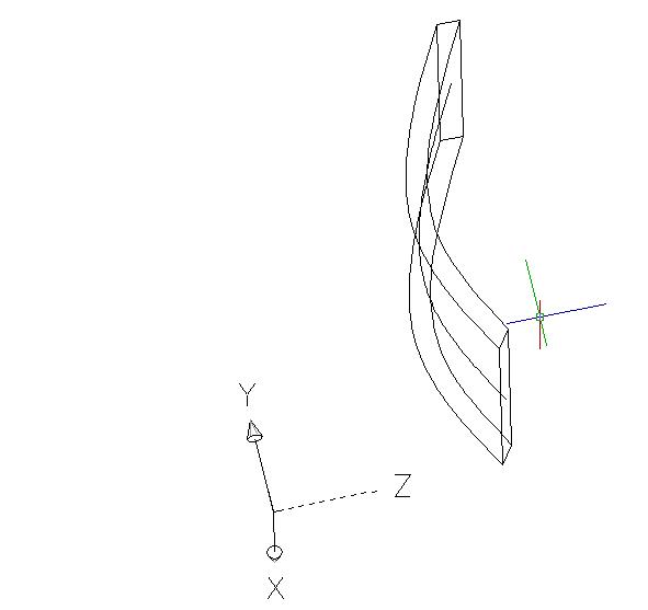

Well, I got it in the end. What I did was place the wall section with its midpoint on the end of the spline. Really strange that it worked this time, because it seems like this is how it should work.
Anyway, thanks for the help!
if you have your rectangle off in space somewhere but your spline is where you want the path it should work just fine. DId you try changing the Alignment option to No? Sometimes the issue arises when cad tries to align an object with a spline path. if it were a straight line there would be no issue.
