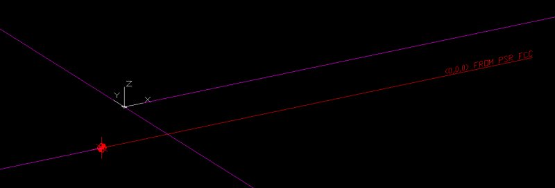

ColinPearson Posted January 18, 2014 Author Posted January 18, 2014 Don't kill too much of your weekend, but I appreciate the help. This has been ongoing over many projects and I usually just deal with it - I can always pick a point and copy or xref based on a known reference point such as CL of a nozzle or something, but I'd like to take that potential error out and just combine the drawings based on 0,0,0 Thanks again! Quote
steven-g Posted January 18, 2014 Posted January 18, 2014 Type UCSICON and select the ORigin option, it places the ucsicon at the current UCS 0,0,0 as long as that is in the viewable area, when you change views the UCS reverts to the world UCS origin, 2 of the lines in your original drawing start at the world UCS. Quote
ColinPearson Posted January 18, 2014 Author Posted January 18, 2014 I am confused... I did not realize that changing the UCS permanently affected the origin. I don't draw using coordinates so I have never noticed this. However, moving the UCS to the ORIGIN option still changes the location depending on the View. That is, if I move the UCS to ORIGIN then change the view and do it again, the UCS moves again so I never have a fixed 0,0,0 Quote

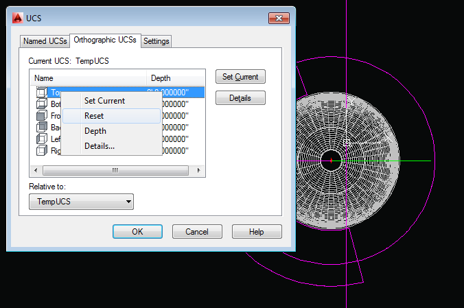

SEANT Posted January 19, 2014 Posted January 19, 2014 There’s an interesting quirk. The UCS Manager (UCSMAN) will not allow a reset to the “World” coordinate system. It will reset to a Named UCS. A new UCS could be created based on WORLD, but given a different name, “TempUCS”, for instance. Then the Orthographic views can be reset based on that UCS. Ideally that would get the views back to what ReMark has in his file in Post #7. In the attached, I rest the Orthographic views based on the center of the circular hole in the upper bracket plate. That is an interesting bit of functionality I’ve never used before. Rx_NewBase.dwg Quote
ColinPearson Posted January 19, 2014 Author Posted January 19, 2014 @steven-g, I don't know why it's different. I move the UCS to a face or something like that pretty regularly, but I try to always type UCS>World afterwards b/c I figured that would reset it to the original one. There's probably times when I've forgotten to and maybe that's how it got changed, but I did not intentionally change it. doh! @SEANT, I'll look today after (I've made coffee), but you're saying that I can not change the UCS that is invoked in the various Views, but I wonder if I can change the origin coordinates with it? .... Nope, well, kind of. I used the the UCS Manager to figure out which View's origin is not aligned with World, and then went back to the drawing, selected that view and used UCS>Origin to move the origin to that point in the offending View. It acts right, but back in the UCS Manager, the offending View still shows some non-zero coordinates for the UCS with respect to the World Origin. And when I switch Views and then back to the offending one again, 0,0,0 is no longer at the point where I moved it to. Sounds like you're idea of defining a Named UCS might be the ticket. Thanks very much folks! Quote

SEANT Posted January 20, 2014 Posted January 20, 2014 . . . . but I wonder if I can change the origin coordinates with it? . . . . Yes. With a named UCS set to world ("TempUCS" for example) the Orthographic Views can be reset. This was the image I was suppose to include in my post above. Quote
