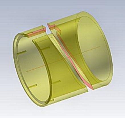

When it comes to AutoCad 3D modeling I am a complete newbie. I am currently working on a project where I need to cut a helical slot in a cylinder which will become a cam. The cylinder will be stationary but there are other parts that will rotate inside the cylinder that will have cam followers on them that will follow the cam slot cut in the cylinder. Now it has been suggested to me to create the slot in the cylinder that I have already create the model for that I will need to create a helix and extrude along the helix path. Then subtract the helix model from the cylinder model. I am just not sure how to do this and could use alittle input.
Also I am having abit of trouble getting the codes for Helsurf and Helcon shown in this topic to work. I have copy'n pasted them into Notepad and saved them as .lsp, but when I load them into Autocad and try to run them I keep getting "Unknow command" error. I am not positive but I think it might have something to do with the ( at the beginning of each code line. Is this suppose to be a " ( " instead?
This is a image of the part I need to draw. Just not sure how to draw the slot.
It's hard to see but the slot has 2 straight sections. One at the top and one at the bottom.
Thanks :)
