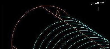

CADTutor Posted November 13, 2002 Author Posted November 13, 2002 Fuccaro Thanks for the revised lisp file. I just tried it out and it works a treat. I used it to create the path for this extrusion: The solid extrusion is faceted because of the increment between points on the 3D Polyline. Do you think it would be possible to allow the user to set the increment? Also, it is possible to spline the resulting helix but AutoCAD won't allow an extrusion along a splined 3D Polyline. Has anyone found a way round this? Quote
fuccaro Posted November 13, 2002 Posted November 13, 2002 That's easy to change. In the second program line (marked with a comment) setting the number (20) to a higher value the spring will look better. Yes, it's possible to ask the user about a lot of things, like the color, the layer, ... I decided to make programs simple to use. But if you wish, just replace the second line (setq segs 20); segments/turn with this one: (setq segs (getint 'segments?')) I feel frustrated, I don't have possibility to insert images. The new in this program is the possibility to draw a conical helix, and with the number of turns as real. But in your image is just a simple, ordinary cylindrical helix, with exactly 5 turns. As I promised, I will be back with an other program, to extrude on a helix path other shapes, not just circles. I must just test it, than the world may have it. Quote

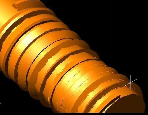

CADTutor Posted November 13, 2002 Author Posted November 13, 2002 You mean like this... ...yes, that works a treat too. Great work Fuccaro, can't wait to test out the extrude routine. Quote

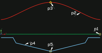

fuccaro Posted November 13, 2002 Posted November 13, 2002 Draw a horizontal line from (0,0,0) -this will be the axis of the helix. Draw a shape, most convenient as a polyline. The distance of the shape from the axis will give the radius of the helix. Start the program. When you are prompted about the number of points of the profile, enter the number of vertexes of the shape, if the shape is open. If it's a close one, you must enter number of points+1. Show the points in order, like when you draw the polyline. To close the shape, the last point must be identical with the first one. Here is a limit of the 3Dmesh size, if your surface will be incomplete and program ends with the message "Warning! surface is trimmed", try again decreasing the quality or the number of turns. (defun C:helsurf () (setq fin (getint " surface quality? (20...1 1=best)")) (setq nr (getint "nr. of points defining the profil?")) (setq nr (1- nr) tri 0) (setq oldc (getvar "cmdecho")) (setvar "cmdecho" 0) (setq lpa (list (getpoint "\n1 point?"))) (repeat nr (setq lpa (cons (getpoint "next point?") lpa))) (setq tu (getreal "\nturns?")) (setq xx (* 360 tu)) (setq xx (1+ (fix (/ xx fin)))) (if (> xx 255) (setq tri 1)) (setq xx (if (> xx 255) 255 xx)) (command "3dmesh" xx (length lpa)) (setq h (getdist "\n pitch (elevation/turn)")) (setq old (getvar "osmode")) (setvar "osmode" 0) (setq fi 0.0 h (/ h (* 2 pi))) (repeat xx (foreach pt lpa (setq ya (car pt)) (setq za (cadr pt)) (setq z (* za (sin fi))) (setq x (+ (* h fi) ya)) (setq y (* za (cos fi))) (command (list x y z))) (setq fi (+ fi (/ (* pi fin) 180)))) (setvar "osmode" old) (if (> tri 0) (prompt "\nWarning! surface is trimmed ")) (setvar "cmdecho" oldc)) Quote
CADTutor Posted November 14, 2002 Author Posted November 14, 2002 Yep, that works too... I have just one criticism of this routine. Why not ask the user to select the profile and have the routine work out the number of points and their coordinates? Obviously, you'd have to stipulate that the profile was formed using a polyline but this would avoid potential errors caused by the user entering the wrong number of points etc. Otherwise it works as advertised. Thanks Fuccaro. Quote
fuccaro Posted November 15, 2002 Posted November 15, 2002 Well, I feel that is enough about helix, -unless if someone will post here interesting special requests and I can help. My intention was (and is) to wrote simple programs, easy to understand and -why not- to use as "skeleton" or part in bigger applications. Thanks to David to quick and useful observations. So, see you in other topics! P.S. I have 3 reasons to post a picture here: 1 -To practice posting images (I hope it works). 2 -To show the results of a combination of the last two routines. 3 -To show to David, I didn't missing from school, when lesson about real numbers was (the number of turns is not an integer) Sorry, it don't works. The image is on my computer. If you wish, make me a visit :evil: (if the image is not here, try this link: http://fuccaro.netfirms.com/screw.jpg And the picture is here, thank you David! Quote
