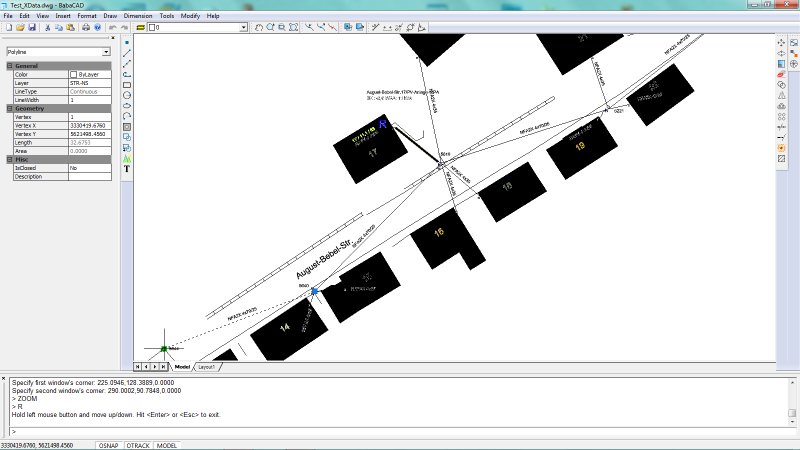

sepultura Posted January 15, 2014 Posted January 15, 2014 (edited) I think ReMark told you the simplest solution. I have tried it, and it works. You even don't need lisp function. Just save your dwg as dwg 2004 in acad lt (or use autodesk free dwg convertor TrueView), open that dwg in BabaCAD and just save it as dxf. See picture below. XData is not implemented in BabaCAD yet, so it is good for you. You have OFFSET command for polylines fully functional, and if you work in GIS, you will find support for inserting geoereferenced images in BabaCAD (tif/tfw, jpg/jgw, bmp/bpw; this feature you can't find in AutoCAD, only in Autodesk Map or Raster Design). All they'd have to do is use BabaCAD for lisp routines then AutoCAD for everything else. BabaCAD is so far from complete it's almost useless for anything but LISP routines IMO. Maybe it's useless. I just know that I've invested more than 3 years of work on this project. BabaCAD is only 3 Mb size (approx. 10 sec. download time). It doesn't hurt to try it. Edited January 15, 2014 by sepultura Quote

Tyke Posted January 15, 2014 Author Posted January 15, 2014 I think ReMark told you the simplest solution. I have tried it, and it works. You even don't need lisp function. Just save your dwg as dwg 2004 in acad lt (or use autodesk free dwg convertor TrueView), open that dwg in BabaCAD and just save it as dxf. See picture below. XData is not implemented in BabaCAD yet, so it is good for you. You have OFFSET command for polylines fully functional, and if you work in GIS, you will find support for inserting geoereferenced images in BabaCAD (tif/tfw, jpg/jgw, bmp/bpw; this feature you can't find in AutoCAD, only in Autodesk Map or Raster Design). Maybe it's useless. I just know that I've invested more than 3 years of work on this project. BabaCAD is only 3 Mb size (approx. 10 sec. download time). It doesn't hurt to try it. [ATTACH=CONFIG]46302[/ATTACH] Stripping off ALL of the XData is NOT what is required. The XData HAS to be retained on all existing objects. It's just the NEW objects that have to be XData free. Quote
sepultura Posted January 15, 2014 Posted January 15, 2014 Maybe you can just copy offseted polylines to original drawing, but that would be hard work. I will try to add xdata in next version. Quote
