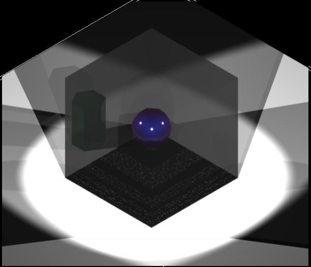

ReMark Posted January 14, 2014 Posted January 14, 2014 Disclaimer: I am still a novice when it comes to working with materials and applying lights so keep that in mind when viewing the image below. There are four objects in this 3D model. They are the flat surface (white), the cube (light gray), the sphere (blue) inside the cube and the polygon (green) sitting outside the cube. The cube has been made to be transparent (70%). I think this is what you are attempting to achieve is it not? The materials applied were a mixture of paint and metal. The objects are lit by three spotlights. Quote

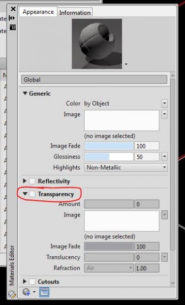

miroslav_s Posted January 26, 2014 Author Posted January 26, 2014 Hi Cico, and sorry for not answering earlier. I did not check my post for a couple of Days thats´s why. I´m gonna download your file to check it out. When I logged in today I was gonna post my answer to my own question and of course to write a second question here. So here is the text that I planned to post today: "OK, I thinkI finally managed to do it. What I did was to set GLOBAL transparency to 80.Before it was 0. Even when I set transperancy to all the materials to example 80 the rendering went wrong and I think it was because GLOBALtransparency was set to 0. I am not sure only guessing of course Now when I render it I get the result that I want. Now to mysecond question (I always have one J .How do I set me render commandto do a closer rendering? Where to I set that option? This is how “far” myautocad render the object. I guess it can be done much closer,right? http://prntscr.com/2mrtry Bestregards and thanks in advance, Miro" Quote
