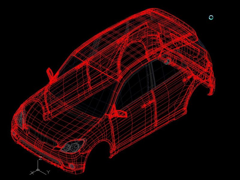

Had a quick look we have Transoft Autoturn they have some great car samples Noldyb go to their webiste and ask for a copy, if you look at the complexity it takes hours.

F700es the car is one of many supplied as a sample with Autoturn. Even a semi.

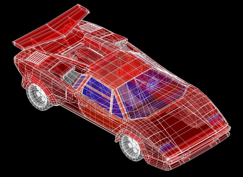

I think your 3D car should be created using polygon meshes, like the above image depicts, not solids.
Note: I did not create the 3D model nor can I tell you how to do it using meshes as I do not use them in my line of work.
I like it. I think we should use that PDF as a competition on CADTutor. ;)
f700es yeah its like Remarks example mesh and faces.
