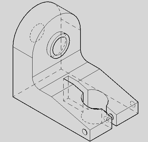

derek193 Posted January 10, 2014 Share Posted January 10, 2014 I am currently using the visual style "Wireframe" and cannot seem to figure out why my lines won't plot out as dashed lines even though they are dashed in my layout. I have been playing around with my LTSCALE,PSLTSCALE but nothing seems to be working. Any Suggestions would be awesome. Current Visual Style Setting (WireFrame): Edge Settings: Facet Edges Occluded Edges: Yes Linetype:Dashed Intersection:Yes Silhouette Edges:Yes Quote Link to comment Share on other sites More sharing options...
Tuns Posted January 10, 2014 Share Posted January 10, 2014 Under plot style editor, check to see that all the colors are set to plot using the objects linetype. That's all I can think of. Quote Link to comment Share on other sites More sharing options...
ReMark Posted January 10, 2014 Share Posted January 10, 2014 This is a 2D drawing is it not? Try the following: Set PSLTSCALE=1, MSLTSCALE=1 and LTSCALE=0.5 and see what happens. Quote Link to comment Share on other sites More sharing options...

nestly Posted January 10, 2014 Share Posted January 10, 2014 Select the viewport and check if the Shade Plot property is "As Displayed" Quote Link to comment Share on other sites More sharing options...

derek193 Posted January 10, 2014 Author Share Posted January 10, 2014 Well I have a 2-D wireframe, 3-D wireframe and just a wireframe in my visual style manager. I am currently on just wireframe cause when I use 3-D wireframe it plots out really thick and awkward looking with no dashed lines. The wireframe visual style atleast plots out clear but just missing the dashed lines. Quote Link to comment Share on other sites More sharing options...
ReMark Posted January 10, 2014 Share Posted January 10, 2014 Is this the look you are trying to achieve? Quote Link to comment Share on other sites More sharing options...
nestly Posted January 10, 2014 Share Posted January 10, 2014 Here's a demo using 2012. I only went to preview, but I assume it will plot as displayed. Quote Link to comment Share on other sites More sharing options...
derek193 Posted January 10, 2014 Author Share Posted January 10, 2014 Yes that is exactly what I am trying to achieve. My layout shows that exactly but does not come out with dashed lines when I plot for some reason. Quote Link to comment Share on other sites More sharing options...
ReMark Posted January 10, 2014 Share Posted January 10, 2014 To whom are you addressing your comments? On the off chance you were speaking to me I did a test plot of the 3D model I posted the image of. First plot resulted in no dashed lines being plotted. So I went back to my layout, made the viewport active, set the variable VSOBSCUREDEDGES to 1 and saved my drawing. Then I popped back into my layout and replotted. The second plot did have dashed lines. Quote Link to comment Share on other sites More sharing options...
