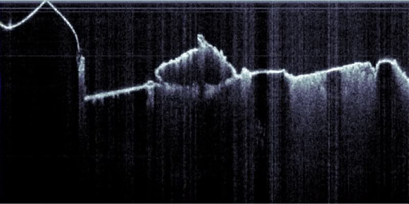

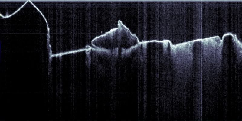

miazanoapte Posted November 30, 2008 Author Share Posted November 30, 2008 No. I have a few hundred pictures of an OCT analysis, taken as the laser walked over a probe. They kind of look like this: My task is to create a single image of the probe in 3 dimensions from them, and I've been told to use either AutoCAD or 3DS MAX. As I said, I'm absolutely clueless about how something like this could be done, so I hope someone here isn't . Thank you. Edit:the guys that analysed the probe did this with a software of their own making, to which i sadly do not have access, so I have to try with something else. Quote Link to comment Share on other sites More sharing options...

shift1313 Posted November 30, 2008 Share Posted November 30, 2008 remark, oct is Optical Coherence Tomography. Its basically an xray of a part for material science purposes(and other applications). The image he is showing is basically a slice of some object i think. Miaz, im sorry but i know of no way you can take jpeg images and create a 3d object. You can import jpeg images as raster image files and "trace" over your white lines creating a reference line that can be used. im assuming the jpegs you have are at different "heights" and you need to stack these images and create a solid of some sort? This will be very imprecisise and impractical. What is the probe of? do you have a picture or an actual part? What are you going to get by recreating this? The OCT stuff should be used to find cracks or intersticial spaces in the material. Are they wanting you to create the imperfections? Quote Link to comment Share on other sites More sharing options...

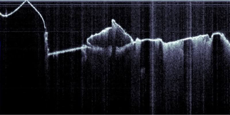

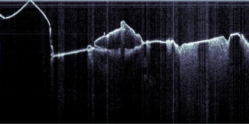

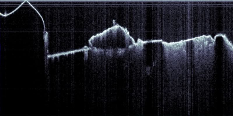

miazanoapte Posted December 1, 2008 Author Share Posted December 1, 2008 I only have the jpegs. A friend told me something about inserting a jpg, placing dots, raising the ucs (what's that?) inserting another photo and ading dots and so on. Didn't understand much really . I'll place the photos here with image tags if you don't mind: For the first part i only have to get it done. I really don't know what's in store for me afterwards. Also, notice that loop in the upper left corner, it's a strange aberation but i can neglect it for the time being. Quote Link to comment Share on other sites More sharing options...

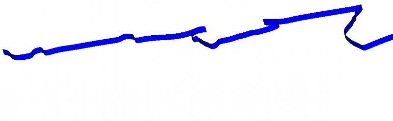

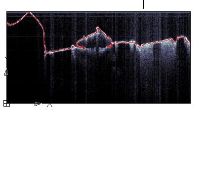

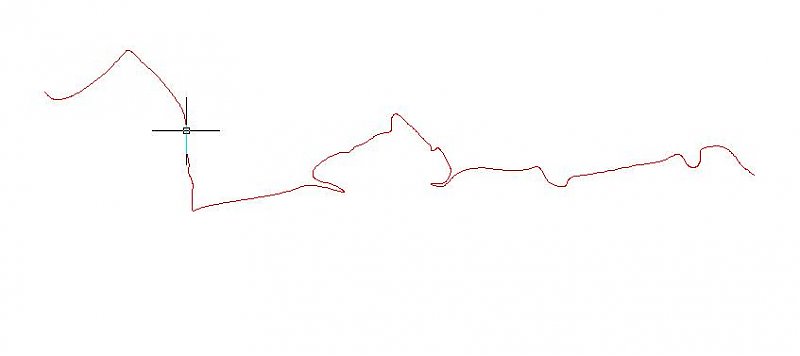

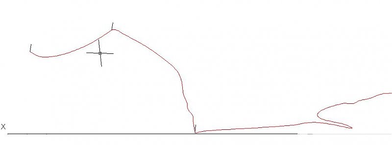

shift1313 Posted December 1, 2008 Share Posted December 1, 2008 I did this real fast for one of the images for you. This is not a precise method. You will never get a precise part off of a jpeg! I used insert, raster image and put the jpeg in my drawing. then i used the spline command and turned Osnap off(or else you will snap to the edges of your drawing) and traced the while lines as best as i could. I did this in multiple line segments. each time i ended a segment and started a new one i turned osnap back on so it would snap to the end of the last line, then turn it back off and continue tracing. After i was done i drew vertical lines representing my height between photos. At this point i would start a new layer and turn this layer off moving my ucs to the end of one of my vertical lines. You will always default to drawing in the XY plane. For this i just copied my first line up to show you cause i dont have the time to draw a second one. then i used edgesurf to create a surface. you need 4 lines to use edge surf. two vertical and two of my splines. You can see this will be a very long inaccurate process. Quote Link to comment Share on other sites More sharing options...

miazanoapte Posted December 1, 2008 Author Share Posted December 1, 2008 Yes, the photos are hard to follow for me too, not being a real expert and all. Basically you have a surface seen from an eagle eye (the laser's) point of view. The laser shoots across it and what you basically see is how deep it goes. Then the probe (or the laser) is moved by a certain distance and the process repeats. The photos were coordinated with the laser. The lab-boys that made the scan had a program built specialy for this and they got a great result. Sadly, we do not have access to that program so I've got to find a way to deal with something else. I guess the best thing that could happen would be this: It really doesn't have to be that fabulous, a stationary 3D model retaining the information of the tomography would do. Quote Link to comment Share on other sites More sharing options...
shift1313 Posted December 1, 2008 Share Posted December 1, 2008 are these 4jpegs each side of a model? I understand what the picture is saying but im having trouble deciphering what the object actually is. Quote Link to comment Share on other sites More sharing options...
