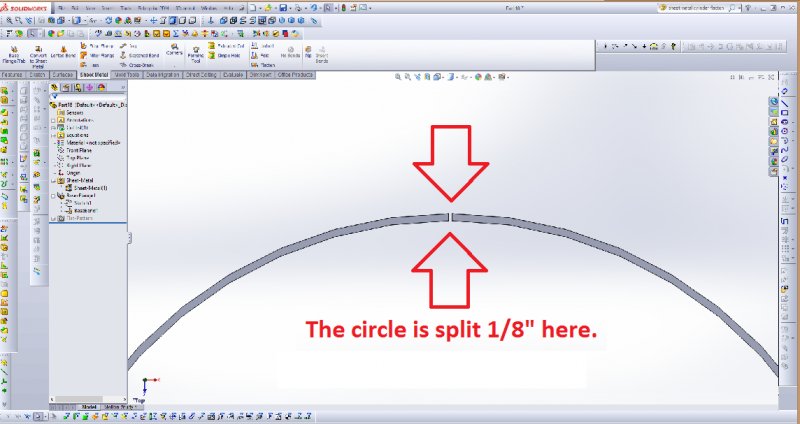

I found a way to create the cylinder, but I don't know if this is the correct way to do it.
I sketched a circle that was 30.00"Ø.
Then, I trimmed out 1/8" out of the circumference of the circle, so that, now the circle was not a complete circle.
I then went to SHEET METAL, and created the 36" tall cylinder, with a 0.25" wall thickness.
The cylinder will now FLATTEN, and UNFLATTEN.
I just have to remember that when I need to know the length of the cylinder, when it's flattened, I have to ADD the 1/8" that I originally removed from the circle.
This is the end result.
If this is NOT the correct method, someone please let me know.

Actually, I was just informed that, when they construct a cylinder, they will roll the steel to where the 2 ends almost meet, leaving the 2 ends 1/8" apart from each other, to allow for welding. So, I guess, until someone shows me a better way to create a cylinder, this way will have to do.
Hi Vert,
Unfortunately, this is the correct way to do a rolled cylinder in Solidworks (e.g. creating a circle and breaking it at a point.
