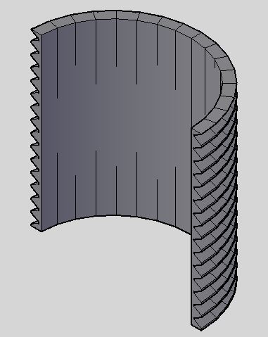

Addendum:
Test completed. There were no interactive screens. Answer the questions, wait while program does its thing, finished. I tested the routine using AutoCAD 2013.
Results of test done using AutoCAD 2013.
Metric template.
Diameter = 30
Pitch = 2
Length of threads = 25.4
Visual style = Conceptual
Note that on systems where the user has the minimal amount of RAM installed the process may take some time to complete.
