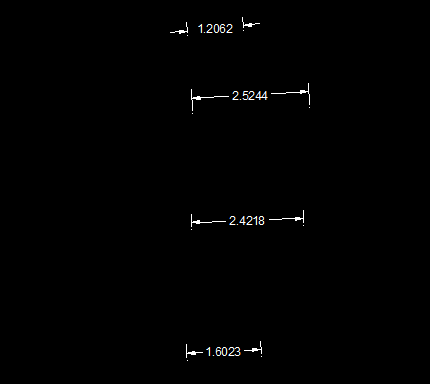

need lisp for automatic creation of polyline
Hi .
Are you after drawing a polyline on the left side hand coordinates of the selected dimensions ?
I need for right side
Edited by rk25134
Try this ...

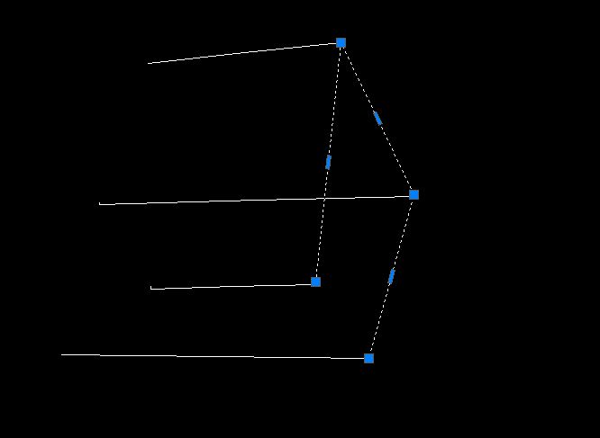

thank you its working, please provide for left side also.
thank you its working, please change the below code to right side
Just change the number 13 to 14
After changing 13 to 14 I am getting incorrect way as please find the attached screenshot
Did you try my routine ?
Yes your routine is working fine. need same for left side also.

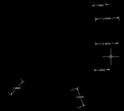

Like to think the actual drawing would be more complex than the one you posted rk25134 , would you be so kind to post a more realistic drawing sample.
Edited by pBe

Please find the attached screenshot. I Used latest routine and enter right option from the lisp
