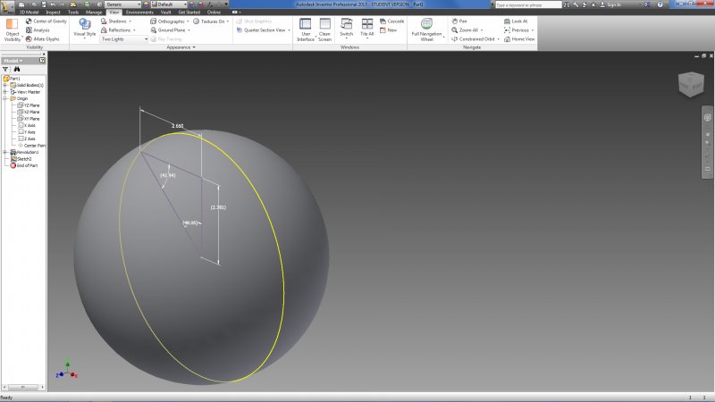

mattador04 Posted January 5, 2014 Share Posted January 5, 2014 I have a sphere. It is 7.125" in diameter. The origin is right in the middle, and I have work planes offset from the origin planes, say, 8 inches. There are 4 such planes, and there are 2d sketches of 5.25" dia. circles on each. I made a 3D sketch and projected them to the surface of the sphere, using the 'project along vector' option in the project to surface command dialog box. Here's the question: how do I trim portions of that 3d sketch on the surface of the ball? See pic. Any input is appreciated. Quote Link to comment Share on other sites More sharing options...

Bishop Posted January 10, 2014 Share Posted January 10, 2014 The circle will be projected to any part of your selected "project to" face that intersects that circle in a direction normal to the plane on which the circle lies. Your sphere only has one face, therefore the face crosses that projected circle in two places ... so you get two projected circles. If you don't want to have the circles projected to both sides of the sphere, you need to split the surface of the sphere into multiple faces. Quote Link to comment Share on other sites More sharing options...

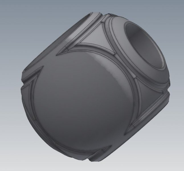

mattador04 Posted January 11, 2014 Author Share Posted January 11, 2014 Interesting indeed. Once I trim out the eye shaped portions where the circles intersect I will attempt to sweep a profile along it for a concave sort of groove. It is a ball for a valve. Quote Link to comment Share on other sites More sharing options...

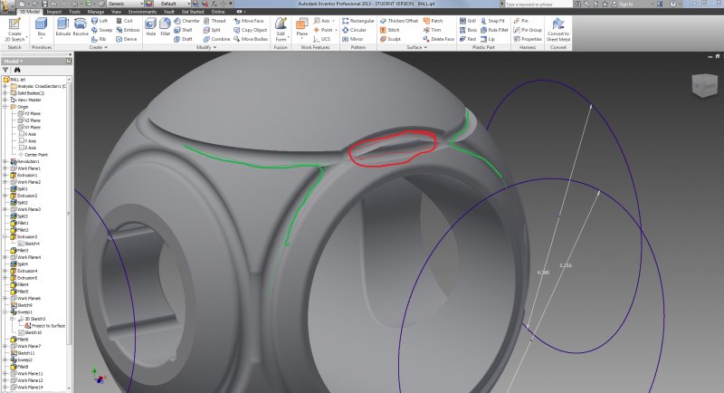

mattador04 Posted January 14, 2014 Author Share Posted January 14, 2014 Check it out. The lines in red need to go. The profile marked by the green lines have to stay. I know you know what to do. Help please pretty please. -Matt Once installed in the valve body, the ball will rotate 90 degrees about the x axis Quote Link to comment Share on other sites More sharing options...
Davarn Posted January 14, 2014 Share Posted January 14, 2014 Hello everyone, I'm new to this forum, and relatively new to Inventor. I have never needed to use 3d sketches much, but I thought I would try this challenge. After breaking the link of the projected circles I went into the 2nd 3d sketch and included the circle of the first 3d sketch, trimmed them off and drew a 2d circle on each path and then swept the groove. Unfortunately I am using 2014. Sorry, but perhaps the above info will help. Dave Quote Link to comment Share on other sites More sharing options...

Davarn Posted January 14, 2014 Share Posted January 14, 2014 I believe I was able to break it by right clicking on the projected loop in the browser. I expanded the 3d sketch until it exposed the loop and then right clicked. Of course I am using 2014, so it may be different. Quote Link to comment Share on other sites More sharing options...
