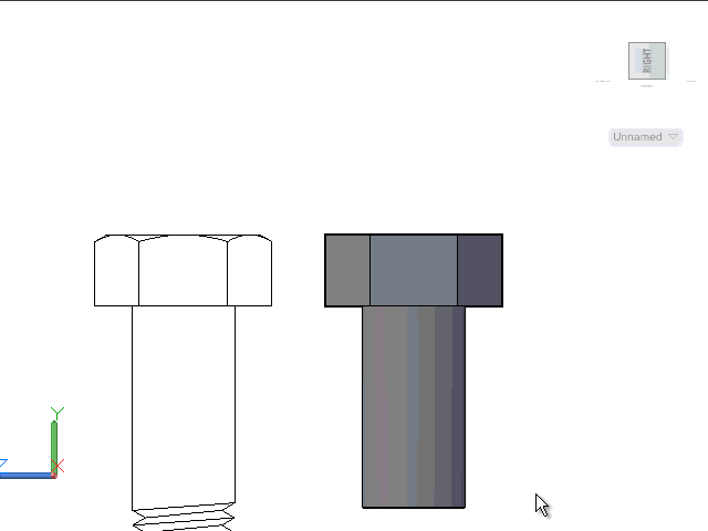

HobbitHills Posted January 5, 2014 Share Posted January 5, 2014 making a hex head bolt. draw a 6 sides polygon. turn it into a region. extrude it a little bit. Then how do can you put a simple chamfer on one end? Quote Link to comment Share on other sites More sharing options...
The Ninja Style Posted January 5, 2014 Share Posted January 5, 2014 JDM's Tutorial #4 http://home.pct.edu/~jmather/content/CAD238/AutoCAD_2007_Tutorials.htm Quote Link to comment Share on other sites More sharing options...
Dadgad Posted January 5, 2014 Share Posted January 5, 2014 Try the CHAMFEREDGE command. Quote Link to comment Share on other sites More sharing options...
HobbitHills Posted January 5, 2014 Author Share Posted January 5, 2014 Yes. Thank you. Was a little hard to select the edges but finally go there. Quote Link to comment Share on other sites More sharing options...
Dadgad Posted January 5, 2014 Share Posted January 5, 2014 Yes. Thank you. Was a little hard to select the edges but finally go there. Glad you got it. Probably easiest to select when in an ISOMETRIC perspective, so that you can really see what you are picking. Quote Link to comment Share on other sites More sharing options...
nestly Posted January 5, 2014 Share Posted January 5, 2014 Alternately, this is the type of chamfer on all the bolts I use. Quote Link to comment Share on other sites More sharing options...
Dadgad Posted January 5, 2014 Share Posted January 5, 2014 Masterfully conceived and demonstrated nestly, as usual. Quote Link to comment Share on other sites More sharing options...
HobbitHills Posted January 5, 2014 Author Share Posted January 5, 2014 Excellent suggestion. Seems very straight forward. Of course every thing does when presented as this was. I'm off to draw a three strand rope looping along the ground! that should keep me busy and confused for.............ummm...........(longer then I want to say). Any suggestions? Quote Link to comment Share on other sites More sharing options...
