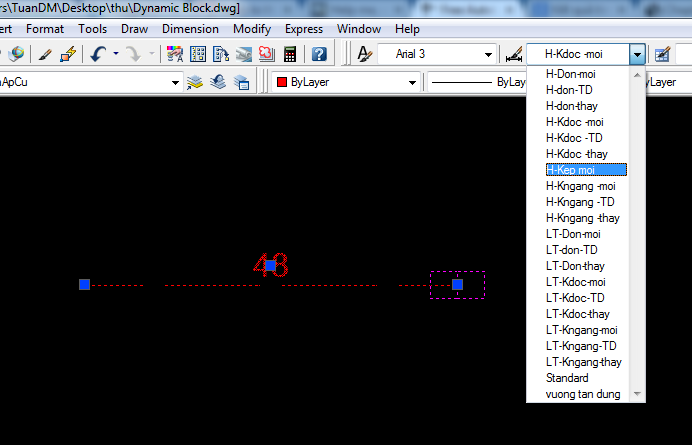

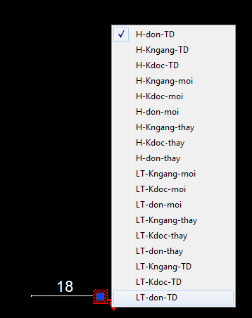

minhphuong_humg Posted January 4, 2014 Posted January 4, 2014 I created Dynamic Block visible with blocks. But I don't know how dimension with Dynamic Block first rowahead (Dimension style). I very try but don't success. Please, create dimension with Dynamic block visible. Purpose, I drawing as I sent to you. I can select from list Dynamic block visible instead go to change dimension style on the Styles bar (Dim style control). Please, help me. Thank you very much. File Dynamic Block visible Dynamic Block.dwgFetching info... Quote
steven-g Posted January 4, 2014 Posted January 4, 2014 If I have understood the question corectly the attached block should work, but with the limitation that you can only use one dim arrow style in the drawing, which is possibly what you don't want. Unfortunately when you use the block as a user arrow it is not inserted as a block in the same way as a normal block, so you would have to create a dim style for each type, or if one style per drawing is ok then the nested block solution will work. So I used your dynamic block "PC" and created another block called "dim-style", and used the block called "dim-style" to create the user arrow. Now you can place your dims and if you want to change the style you have to open the block called "dim-style" in the block editor to change the visibility state. I'm afraid that is the best I could do. Dynamic Block.dwgFetching info... Quote
minhphuong_humg Posted January 5, 2014 Author Posted January 5, 2014 steven-g said: If I have understood the question corectly the attached block should work, but with the limitation that you can only use one dim arrow style in the drawing, which is possibly what you don't want. Unfortunately when you use the block as a user arrow it is not inserted as a block in the same way as a normal block, so you would have to create a dim style for each type, or if one style per drawing is ok then the nested block solution will work. So I used your dynamic block "PC" and created another block called "dim-style", and used the block called "dim-style" to create the user arrow. Now you can place your dims and if you want to change the style you have to open the block called "dim-style" in the block editor to change the visibility state. I'm afraid that is the best I could do. Dir, steven-g I'm trying to make fast, more convenient. Doing so will take longer than usual to drawing a Dimension and Dimension change in the style (Style Dim style control on the Toolbar) or go to Properties> Misc> Dim Style)? How long have than normal? Normal (my routine): I hope faster chage dimension (without go to dim style) with Dymension block visible: So I ask: Is it not possible? I can do faster by that? Or even better solution for jobs that I usually do not? Please, help me. Thank you very much? Quote

steven-g Posted January 6, 2014 Posted January 6, 2014 That's clearer, do you mean something like this. Insert the block then stretch the block to suit, you can change the visibility state, you will need to do a rREGEN each time to update the information. I used an attribute to show the dimension so you can use the ATTEXT command (I think it's dataextraction in full Autocad) to get the sizes into excel, the png image didn't show up so I'm not sure what other info you need to extract to excel, but it should be easy enough to add a few more attributes if needed. Dynamic Block.dwgFetching info... Quote
minhphuong_humg Posted January 7, 2014 Author Posted January 7, 2014 steven-g said: That's clearer, do you mean something like this. Insert the block then stretch the block to suit, you can change the visibility state, you will need to do a rREGEN each time to update the information. I used an attribute to show the dimension so you can use the ATTEXT command (I think it's dataextraction in full Autocad) to get the sizes into excel, the png image didn't show up so I'm not sure what other info you need to extract to excel, but it should be easy enough to add a few more attributes if needed. Oh, very very good. Thank seven-g very much. It is to my liking. I mean exactly that. I want to do so to extract excel distance. I will try to draw a drawing with the same block. Then will use dataextraction to excel. I will report results for seven-g. I will try immediately. Quote

steven-g Posted January 7, 2014 Posted January 7, 2014 Strange, it works fine here. I changed the name of the block just in case it was causing a conflict on your system. Did you do the REGEN Dynamic Block.dwgFetching info... Quote
