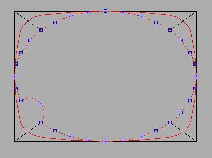

I just tried tracing it with a Polyline, as numerous short arcs, using lots of the NEAREST osnaps, hoping I would be able to grip stretch
it into submission? Quite an unimpressive result, if I say so myself.

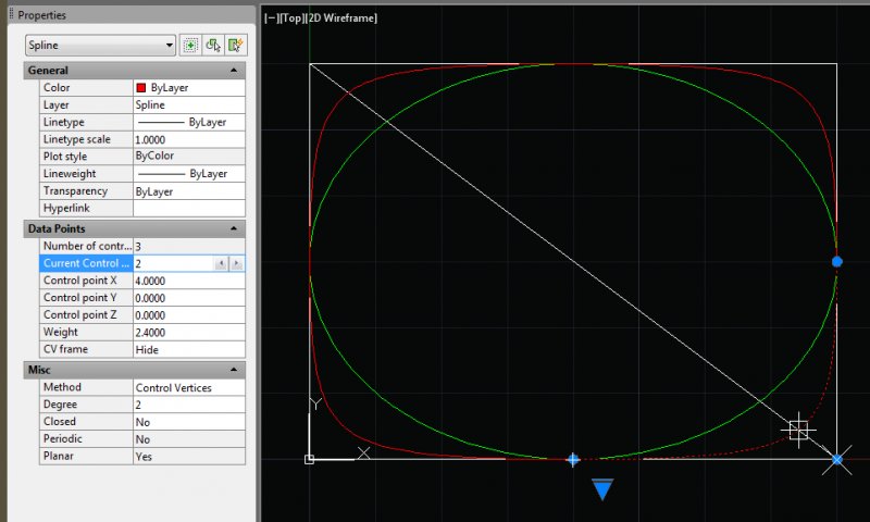

Are you familiar with the BLEND command?
Due to the shortage of grips, if you do use the STRETCH function, it will only stretch along one of the existing axii.
Another option may be to construct a quadrant out of a degree 2 spline. The weight of middle Control Vertex can be modified until it passes through the desired point.
That is almost the shape I got with a polyline drawn through the midpoints of the sides and the midpoints of the trimmed off diagonals. I drew it as straight lines then curve fit with tangents specified at the sides and top.
Drawing an ellipse as a polyline (setting PELLIPSE to 1) does not help as the polyline changes into curves, each with a mind of its own :shock:
OMG that was so simple...
Thank you so very much everyone but I wish I could give SEANT a "best answer" kind of thing like with yahoo answers. Thanks you, the spline worked perfectly. I was "monkeying around" with stuff for 2 hours and completely forgot about splines...
