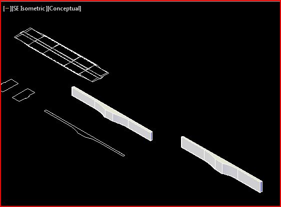

I am knowledgeable on how to draw my shapes and extrude them to 3D, but am curious is if I need to change the shapes to "solids" for the printer to print it that way? For instance, I have a model train car that I am working on, and I have attached the file below. What I did with this basically is drew the shapes and extruded them to the thickness that I needed (Measurements are actual size and will need scaled down after the model is complete).
So If I need to make them a solid, how do I accomplish that, and then join the separate objects into one complete model ready for printing? Thank you in advance for your advice!! Glad to be a part of the forum!
P.S. If you need any details about this project, basically I am composing a railroad flat car, and have built the four sides as well as the top deck as separate pieces and will combine them all together as one.

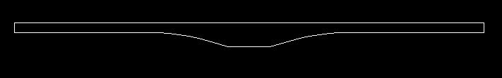

2D Base Objects: This is the basic pieces in 2D wire that are drawn to life scale and have not yet been extruded to the proper width.
3D Rendering: This is a model i drew up before I realized I might need to make the pieces solids for 3D.
I couldnt figure out what i needed to do and how to do it...
2D Base Objects.dwg
3D Render (Example).dwg

So since I snapped all of the lines together, they should be closed. I snapped all the corners together, and created an arc for the curved piece. When I extrude them, it is still clear on the inside of the object. Is this considered a solid, or is there a setting I need to activate to make it appear solid instead of a clear 3D object? I am familiar with what the PRESSPULL and EXTRUDE commands do, I just need to know if its creating a solid or not, which to me if it was, CAD shouldn't have made it transparent...

If you change your visualstyle from 2D Wireframe, to CONCEPTUAL, or SHADED it will apply color to faces.
Wireframe displays as lines only.

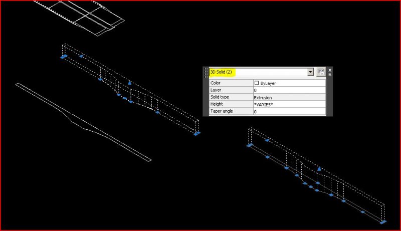

Or you can click on an object, and check in PROPERTIES or QUICK PROPERTIES, it will tell you what sort of an entity it is.
The one one the left I created with PRESSPULL from your lines.
The one on the right from a CLOSED POLYLINE which was EXTRUDED,
net result exactly the same, disregarding the random heights of the extrusions, as shown in the Quick Properties.
Select conceptual visualstyle and they display as shown in the other image.

Al, thanks for all the help! Oddly enough, I couldnt get anything to work with the extrude or presspull to create the solids. I did manage to get the three larger pieces put into regions, which I could then presspull to a solid. The other smaller ones were not coplanar, I found out. Overkill and the other commands did not work.
Well, I played around a little and realized that the lines that made the smaller pieces were on different Z axis, so that is why they couldnt be used as a region. For some reason, I couldn't just select the whole object and set all the line values to 0, so I manually moved the lines individually and snapped them to place and then they all formed the object on the Z axis of 0. After that, I got it to work. Don't really know how or why that happened, but that fixed it.
