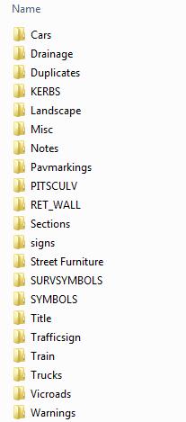

Personally I'm not a fan of the design centre and prefer to use a block library (which resides on multiple files). E.g. a file for street signs, another file for cars, another file for beams etc...

My $0.05 we use CIV3d our survey blocks are contained in the master DWT so a Insert accesses the 5-6 extra ones we need above the auto inserted field data collection a purge a bit down the track removes un-used blocks. We then have a big multi grouped directory of any other block we may need. A lot of these are accessed from a custom menu dialouge done now we would use a palette.
Regarding file size if made individual using wblock you end up with pretty small dwg size 25Kb the other way to make is have a blank template and copy and paste.
I agree with others above do what the boss wants he pays the bills. Look into custom menus etc you can make a mnu file in a few minutes with 100+blocks if you know a few tricks with MS-word. Can explain more if needed.

I like the idea of using .mnu files BIGAL but I've never tried it so perhaps some tips would be great, though I fear I might need to look on other threads?
Do you arrange your files into folders first on a hard drive and then set up links to the folders with code?

To help you big time do the following go to bottom left start then CMD
you need to change to your directory which has all the dwg blocks something like F:
then CD\
then CD \myautocad\blocks\parts C-D
then dir *.dwg >dirdwgs.txt /b
this will make a text file of all your dwgs post it here, will send back a script to make slides etc as well as menu example.

BIGAL, Sorry I haven't got back to you sooner iv been doing site visits and hectic pitches for jobs....
I would love to create a list of the blocks, but does that mean I would have had to have sub divided the blocks up first? I currently have them all in one source file.
If so I would need some time to create this, is it okay to keep the offer open for a little more time so that I can create this block filing method and then in turn generate the .txt file for you?
