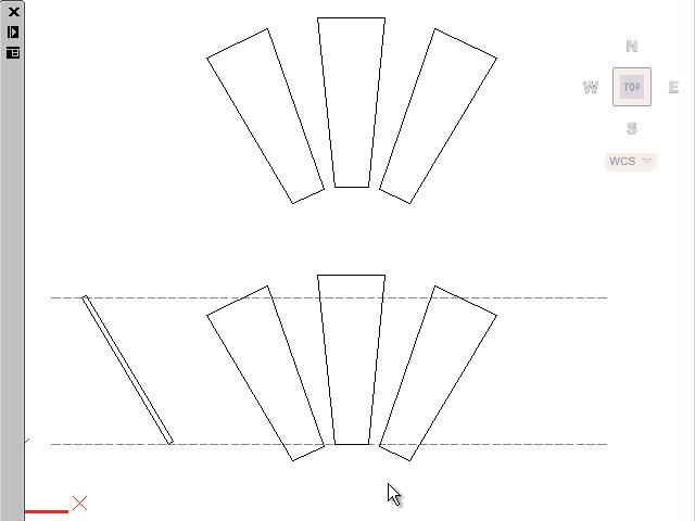

OrangeFu Posted January 2, 2014 Share Posted January 2, 2014 (edited) Hey folks! After an exhaustive search on the forums the closest thread similar to mine was this one, and it was never resolved So here's my question in Video Form... I find at least once every project I need to do something like this (skewing/forshortening). If I make a section view of a set design (cutting right through the stage), I'll do that by taking my set elevations and skewing them. SOLUTION FOUND EDDIT: Holy Balls, YOU GUYS ARE AMAZING. Behold: The solution, painstakingly outlined in VIDEO FORMAT, and annotated..?! Thank you all for sticking with me on this one. You make this community so welcoming and inviting. When you get back up and running, here's a full demo of both the 2D and 3D methods described (assuming I understood Rob's description correctly) Edited January 3, 2014 by OrangeFu Solution FOUND! Quote Link to comment Share on other sites More sharing options...

OrangeFu Posted January 2, 2014 Author Share Posted January 2, 2014 Unfortunately not everyone will be able to view the video (our IT department blocks such sites). Could you elaborate further on just how you want to skew the block? Maybe provide an image or two as well? Thank you. I'm trying to scale an object un-uniformly. So if I have a square object I want to crush it into a rectangle. Quote Link to comment Share on other sites More sharing options...

nestly Posted January 2, 2014 Share Posted January 2, 2014 Is this what you're trying to do? Quote Link to comment Share on other sites More sharing options...
RobDraw Posted January 2, 2014 Share Posted January 2, 2014 A little 3D magic will do this for you. If you go into the left or right view and rotate the objects to the desired angle, then go back to you elevation view, you will have what you need. Quote Link to comment Share on other sites More sharing options...
OrangeFu Posted January 2, 2014 Author Share Posted January 2, 2014 Is this what you're trying to do? [ATTACH=CONFIG]46061[/ATTACH] Woah.. is my Properties panel buggy? http://imgur.com/0nE52Ys Quote Link to comment Share on other sites More sharing options...

RobDraw Posted January 2, 2014 Share Posted January 2, 2014 That solution is not going to give you the correct result. It will squish the block in one direction. The horizontal aspects will remain the same. They need to get smaller in increasing degrees as you go from top to bottom. Please see my previous post. I've heard about the properties block not working correctly. I think there is a solution here in another thread. Quote Link to comment Share on other sites More sharing options...

OrangeFu Posted January 2, 2014 Author Share Posted January 2, 2014 A little 3D magic will do this for you. If you go into the left or right view and rotate the objects to the desired angle, then go back to you elevation view, you will have what you need. The tricky thing is knowing precisely what view angle to use in order to achieve an accurate "Skew". I don't like the idea of playing a guessing game and getting *close* to the right amount of scaling. It has to be precise. Quote Link to comment Share on other sites More sharing options...

nestly Posted January 2, 2014 Share Posted January 2, 2014 Have you used a registry cleaner? If so, you may need to repair/reinstall AutoCAD. http://usa.autodesk.com/adsk/servlet/ps/dl/item?siteID=123112&id=8227659&linkID=9240617 Regarding the original problem, if the lights are planar, I believe the technique I posted will be accurate, however if the outside lights are rotated toward the subject, then those have to be "skewed" independently. If you're at all familiar with working in 3D, that would be easiest way to complete this, IMO Quote Link to comment Share on other sites More sharing options...
eldon Posted January 2, 2014 Share Posted January 2, 2014 I am sure that RobDraw's suggestion will do what you want. It is in effect Rotate 3D using a reference, which would be exact. Can you post a drawing with this block? Then folk can have a go and see if their suggestions work? Quote Link to comment Share on other sites More sharing options...
