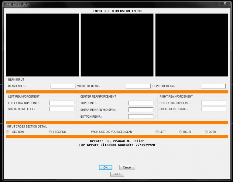

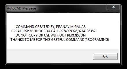

ReMark Posted January 6, 2014 Posted January 6, 2014 (edited) Today is January 6th and I still have not received a reply to my email. My suggestion would be to forget trying to make the lisp routine you have work and instead go to the website I linked to previously and download the RCC Beam Demo zip file. Unzip it to your hard drive so as to extract the RCC Beam Demo.VLX file. Open AutoCAD, start a new drawing and use the APPLOAD command to load the VLX file. The very first thing you will see is this: At the command line type the word BEAM to start the program. Answer the questions that appear. After the last answer is entered you'll see this dialog box appear onscreen: I would assume that at this point you know what information is being asked for and can provide the necessary input. This is as far as I got; the rest is up to you. Good luck. Addendum While checking out other parts of the website I found one additional piece of information. The demo version appears to have a time limit on it. However, I could not find any information regarding what that time limit might be. Edited January 6, 2014 by ReMark Quote
Organic Posted January 7, 2014 Posted January 7, 2014 The very first thing you will see is this: [ATTACH=CONFIG]46123[/ATTACH] Wow... I'm not sure I'd trust a structural program from someone who can't spell reinforcement... Quote
