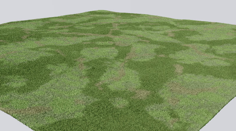

spittle Posted December 31, 2013 Share Posted December 31, 2013 I've found displacement looks ok in mid/background. Attached is a quick example I was messing around with today. The most important thing is getting the correct colour. For something like this use a white noise bitmap on a plane that has dense geometry. For example a 10mx10m plane with 30 subdivisions. Under Renderer tab, enable displacement. Edge length controls the quality/render time. Mental Ray will keep subdividing your mesh until it reaches your desired edge length or the Max subdivs. A displacement map will cause your render time to increase substantially, And like Rod says, unless you use Vray of course. Couldn't resist hehe! Quote Link to comment Share on other sites More sharing options...
