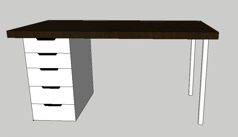

In SketchUp...

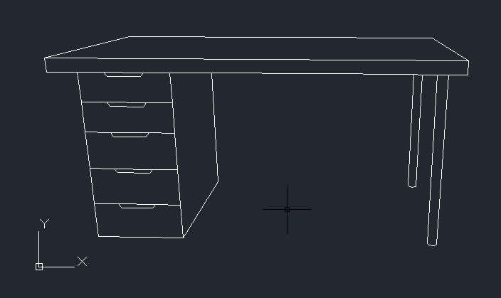

and now the view in AutoCAD...
