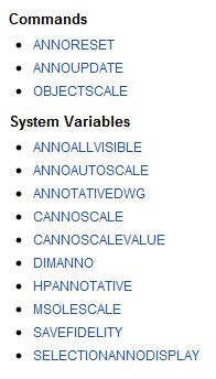

ReMark Posted December 26, 2013 Posted December 26, 2013 Annotation Scaling - Commands and System Variables. Becoming familiar with the above will be important should you choose to use the annotative scaling feature. Annotative scaling can be used with Text, Mtext Dimensions, Blocks, Hatches, Multileaders, Tolerances and Attributes. What is the advantage? "The user can have multiple scales in the same drawing without having to duplicate the content at different scales on separate layers. This technique enables the user to choose what will be seen and at what scale." Source: Isaac Harper - Cadsoft Consulting Quote

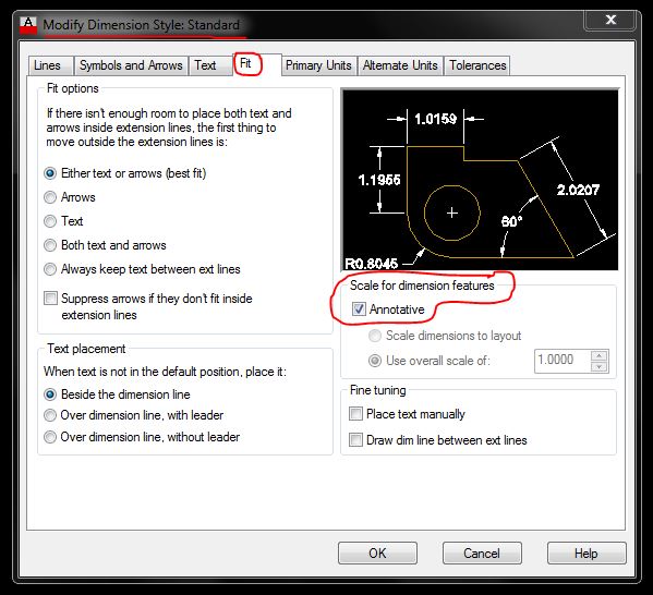

ksc Posted December 27, 2013 Author Posted December 27, 2013 Sorry to bother you again, i am now having trouble with adding dimensions to the drawings, they are appearing very small. I have tried to modify them but still no joy. Maybe i am doing something really silly, please help. Thanks Quote
ReMark Posted December 27, 2013 Posted December 27, 2013 Your dimensions have to be annotative assuming you are placing them in model space. Quote
SuperCAD Posted December 27, 2013 Posted December 27, 2013 When you format your dimensions you have to select the Annotative option on the "Fit" tab. Make sure that your dimension/text sizes are what you want them to print at. In model space, in the lower right hand corner, look for the "Annotative Scale" icon and select the scale that you want to print at. Your dimensions/text will be scaled so they print at the correct height. Quote
