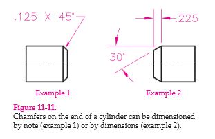

ReMark Posted December 30, 2013 Share Posted December 30, 2013 Is that how chamfers are dimensioned in Taiwan? Quote Link to comment Share on other sites More sharing options...
Tharwat Posted December 30, 2013 Share Posted December 30, 2013 Is that how chamfers are dimensioned in Taiwan? Would Chamfers be different between countries over the world ? Quote Link to comment Share on other sites More sharing options...
ReMark Posted December 30, 2013 Share Posted December 30, 2013 (edited) I'm use to seeing it done differently that's all. I'm assuming that when the OP uses the "C" designation that the chamfer is cut at a 45 degree angle. What if it isn't? What if it were 30 degrees? How would he call it out then? Edited December 30, 2013 by ReMark Quote Link to comment Share on other sites More sharing options...
ReMark Posted December 30, 2013 Share Posted December 30, 2013 This is what I am used to seeing. Quote Link to comment Share on other sites More sharing options...
Tharwat Posted December 30, 2013 Share Posted December 30, 2013 This is what I am used to seeing. Agree , all these chamfered shapes have the same title "chamfer" . aren't they ? Quote Link to comment Share on other sites More sharing options...
ReMark Posted December 30, 2013 Share Posted December 30, 2013 Yes they do. What's missing though compared to the example the OP gave? Quote Link to comment Share on other sites More sharing options...
lucas3 Posted December 31, 2013 Author Share Posted December 31, 2013 [ATTACH=CONFIG]46008[/ATTACH]This is what I am used to seeing. Thank you ! Remark ,Example 1 use Chamfer Dimensions (This page discusses),Example 2 use "dimlinear "+ "dimangular" Quote Link to comment Share on other sites More sharing options...
