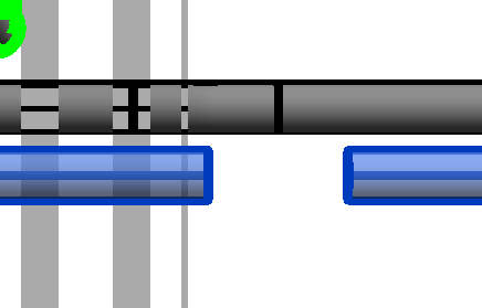

I've got (2) 4" conduits (EMT with fittings) running in a stack. Earlier (before the post) I had tried to break the single conduit run, rotate the final section to match the angle change, and then join the conduits back together using the Trim/Extend. I get and error "no auto-route solution was found"
This morning after your email I was able to do the top one, but not the bottom.

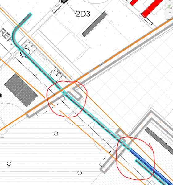

So this problem is shown in the attachement "conduit adjustment 1.png", the second problem I have is trying to jog from two parallel/horizontal conduits to two parallel/vertical conduits. This is in the lower right corner "conduit adjustment 1 and 2.png"

Revit can be quirky at first. You just have to understand "how" Revit wants you to do things. Routing Conduit is actually the easiest of all the Families that "route" (duct, pipe, etc). The thing about Revit is this.... Revit is like a married woman... when something's wrong, Revit won't tell you what's wrong and surely will not tell you how to fix it. You just have to "figure it out" on your own.
In the Project Browser, scroll down to Families > Conduits. You'll notice you have two System Families: "Conduits with Fittings" and "Conduits without Fittings". Duplicate the default, name it accordingly and apply all the default settings that suits your needs. Make sure all the Fittings are loaded that you need, from the default content install directory.
Once you have that set up, you're all set. Initiate the Conduit tool, and in the Properties palette you can select the Conduit Type(s) and begin routing. Below is a screen capture of me routing simple conduit runs, successfully making 15 degree fittings flow easily.
http://screencast.com/t/CQ7oremTf
Also notice how Revit responds when I do things it doesn't "like". Furthermore, I've found it much easier to route a single conduit, then use the Parallel Conduits tool to create simultaneous runs (use the Tab key to expand the duplication from the single segment to the entire run). Sometimes you have to do this in segments, and reconnect bends later - it's a learning process but you'll get the hang of it. And use the Nudge tool when you can (arrow keys, or Shift+arrow keys). It will make your life much easier in the end when coordinating with yourself, or other trades.
Hope this helps! :)
