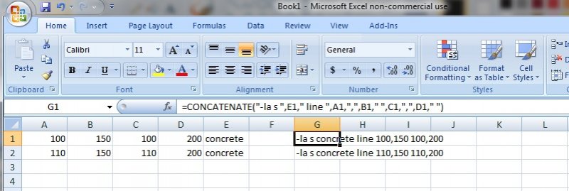

BIGAL Posted December 24, 2013 Posted December 24, 2013 Your data and dwg really dont explain what you want is it the hatching that your trying to produce on a std dwg template ? You could just use excel to create a column that defines the hatch area as a simple pline command then hatch it and you just copy that column onto the autocad command line. Just type -hatch and follow the prompts write down all the steps that what you need for excel. eg column L = -hatch la Concrete B 100,150 200,150 ansi31 Check here by searching for excel "Concatenate" examples. Quote

BIGAL Posted December 25, 2013 Posted December 25, 2013 To draw a line from a column of input in excel this is the simplest way! Just copy column G to the command line. Using a lisp requires a knowledge of lisp to customise for your use. You have to edit the lisp to say which cells are to be used. Anyway if you want to have a go google GETEXCEL.LSP Quote
