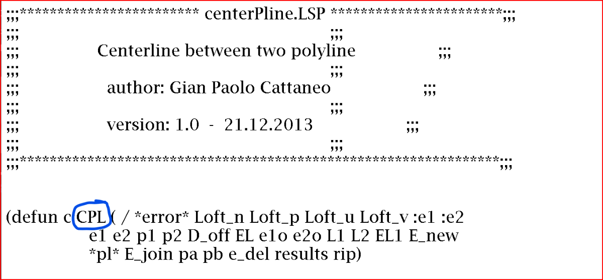

cual es el comando par ausar??
Bien venidos jose rmz.    :)
The shortcall for the lisp is    CPL   like in the screenshot

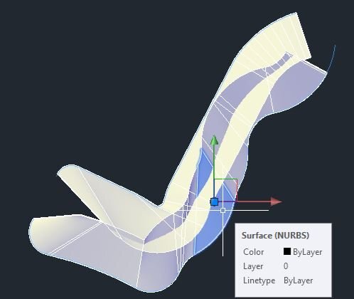

I do not get further than the LISP creating nurbs.
Though from there on I can extract the line with intersect.
Anyone else having this problem?
