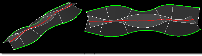

GP_ Posted December 21, 2013 Share Posted December 21, 2013 (edited) A graphical approach to approximate a centerline between two polylines. To play p.s. Do not exaggerate with sharp curves. p.p.s. For AutoCAD 2011 or higher centerPline.LSP Edited February 15, 2014 by GP_ 1 Quote Link to comment Share on other sites More sharing options...

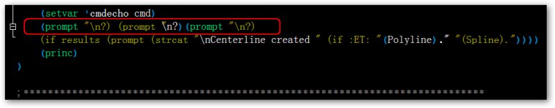

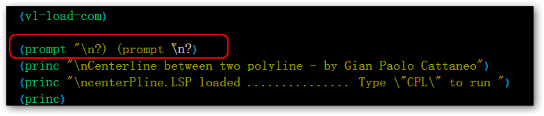

AIberto Posted October 9, 2014 Share Posted October 9, 2014 when appload Command: ap APPLOAD centerPline.LSP successfully loaded. Command: ; error: misplaced dot on input Quote Link to comment Share on other sites More sharing options...
GP_ Posted October 9, 2014 Author Share Posted October 9, 2014 when appload Command: ap APPLOAD centerPline.LSP successfully loaded. Command: ; error: misplaced dot on input Sorry, I don't know the solution for your problem. Quote Link to comment Share on other sites More sharing options...
hanhphuc Posted October 10, 2014 Share Posted October 10, 2014 (edited) Thanks for sharing sir, though i cant try it on 2007 when appload Command: ap APPLOAD centerPline.LSP successfully loaded. Command: ; error: misplaced dot on input i recognize this error happen if dot place before a number. try to separate dot. example: if you see (40 [color="red"][b].[/b][/color]123) at least has space (40 [color="red"][b].[/b][/color] 123) Edited October 10, 2014 by hanhphuc typo: palce -> place Quote Link to comment Share on other sites More sharing options...
AIberto Posted October 10, 2014 Share Posted October 10, 2014 Thanks for sharing sir, though i cant try it on 2007 i recognize this error happen if dot place before a number. try to separate dot. example: if you see (40 [color=red][b].[/b][/color]123) at least has space (40 [color=red][b].[/b][/color] 123) My dear friend hanhphuc , Thank you for your idea, I think I found the reason . just I test it with "vlide" , Found the wrong point . Now I open it with notepad++ Quote Link to comment Share on other sites More sharing options...
