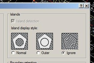

BakedPotato Posted December 19, 2013 Posted December 19, 2013 Hello all, I am working in AutoCAD 2008 on a subdivision plan that has several sheet layouts. The roads in the subdivision are dimensioned and have a pavement hatch. In one of the layouts, however, we want to turn off the dimensions, but leave the hatching. When I freeze the dimensions in that viewport, the pavement hatch is left with holes wherever the dimension text had been. Other threads had suggested going through Hatch Edit > Remove Boundary > Select all the "island" boundaries. When I select the hatch, though, no boundaries show up around the holes left by the dimension text. Is there any way I can turn off dimensions in one layout without leaving holes in the hatch? Quote
Dana W Posted December 19, 2013 Posted December 19, 2013 Hatch edit >> click the Island detection selection for None. Of course, when you turn the dimension layer back on, there will no longer be a void in the hatch around the dimension. Depending on the density of the hatch, it could make the dimensions hard to read. Quote

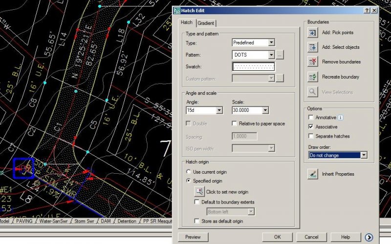

BakedPotato Posted December 19, 2013 Author Posted December 19, 2013 Hatch edit >> click the Island detection selection for None. Of course, when you turn the dimension layer back on, there will no longer be a void in the hatch around the dimension. Depending on the density of the hatch, it could make the dimensions hard to read. I am not seeing the Island detection setting in my Hatch edit dialogue box (see attached screenshot). Also, when I change this setting, will it affect the display of my hatch/dimensions in the other layouts (I'm only turning off the dimensions in one layout)? Thanks for the reply! Quote
ReMark Posted December 19, 2013 Posted December 19, 2013 That's because you neglected to expand the dialog box via the black arrow (in circle) at bottom right hand corner. Quote
Dana W Posted December 19, 2013 Posted December 19, 2013 I am not seeing the Island detection setting in my Hatch edit dialogue box (see attached screenshot). Also, when I change this setting, will it affect the display of my hatch/dimensions in the other layouts (I'm only turning off the dimensions in one layout)? Thanks for the reply! Once you get the dialog window expanded as Remark says, what will be changed is the particular hatch that you edit. Also, while you are in the hatch edit dialog, check "Separate Hatches" so the hatch area you are editing will be disengaged from any others that might have been "Hatched" along with it. Otherwise,, the edit might also affect them too. Are the hatches in modelspace? If so, the change will be shown in any viewport that particular hatch is in. Personally, I never use island detection. I always make sure my hatches are light enough that any dimensions or notes are not obscured by the hatch. I always draworder dimensions to the front. Quote
BakedPotato Posted December 19, 2013 Author Posted December 19, 2013 Oops...thank you ReMark!! I've set the island display style for my hatch to be "ignore" (see image). (No matter which of the three options I selected, the "Island detection" checkbox remained grayed out.) This almost worked, but there are still two renegade text "holes" in my hatch. Any suggestions? Quote
