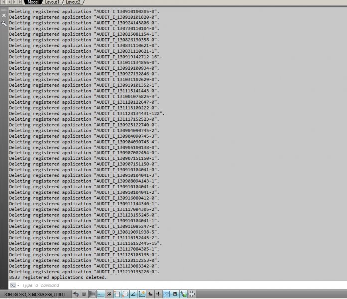

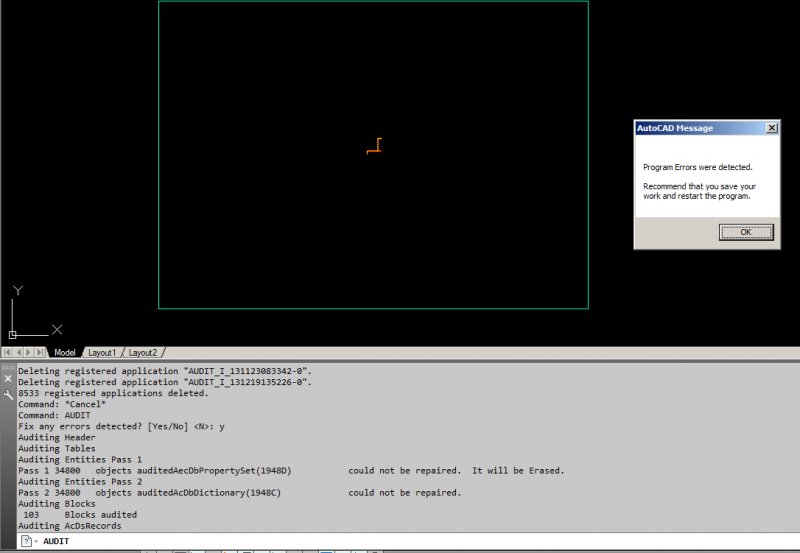

I have some error regarding civil 3d 2014 file i am attaching the error.
thanks
That's a heck of a lot of regapps deleted.
What do you think is at the root of the problem?
what do you think from where these regapp are coming.
thanks
You are using Civil 3D. Where are you getting your data from? Is it an outside source?
No, I meant did you use any content from a drawing done outside the company that you work for?
Not Any data coming from outside we do all the work in civil 3d and autocad.
thanks
Somewhere, something has come from an outside source, or an old file or something - a file created in Civil 2013 from scratch doesn't create that many regapps.
What do you have in your file? X-refs? Data Shortcuts? I would seriously consider recreating the file from scratch.
