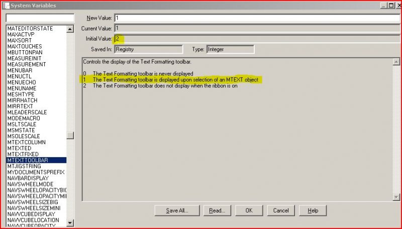

Sounds like your MTEXTTOOLBAR system variable value is set to 2 (the default value), as described in the screenshot, set it to 1.
Thanks much. After a bit more of search I was able to fing the MTEXTTOOLBAR Syntax and change that to 1. Its strange that you cant change the height when you are in Ribbon mode unless you have that set to 1 so it brings up the awesome Classic editior box.
Also, that screen shot, is that something I can find in AutoCAD. Ive been wanting a list of commands and system variables so i can have a greater understanding of commands.
Should be in 2010, sysvdlg on command line or Express>Tools>System Variable Editor...

Sorry I didn't mention that you just needed to enter the system variable name at the commandline,
in order to query the current setting, and change it.
As SLW noted, the SYSVDLG command brings up this wonderful library of available system variables and their numerous options.
Once you get into the dialog box, do yourself a favor and use the SAVE button at the bottom of the dialog box
to save an .svf (system variable file), which will be a good thing to have at some time down the road.
In case you ever need to restore your personal favorite configuration, or load those settings onto another machine.
Spend an hour or two, flipping through the list on a day when you are so inclined and not time constrained.
You'll learn plenty. Just remember save your settings before you start monkeying around, and take notes of the variables you are changing,
in case you find a couple you want to change back. :)
