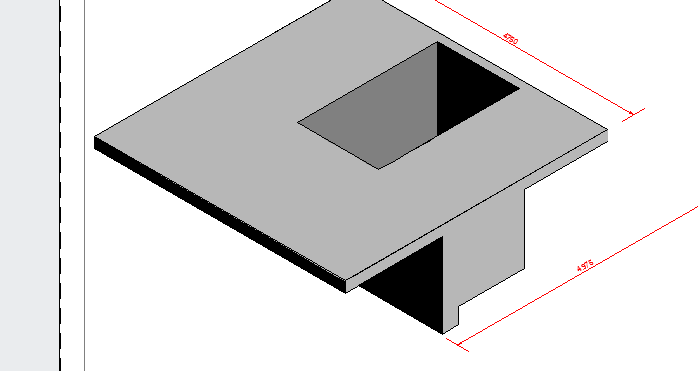

akarees8080 Posted December 17, 2013 Posted December 17, 2013 Hi Guys - Can someone tell me how to chamfer an isometric box. I need to do the 2 front edges but unsure. Cheers, Andrew CAD 2014 Quote

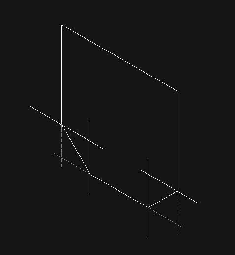

rkent Posted December 17, 2013 Posted December 17, 2013 Assuming we are talking about a 2D isometric drawing, measure up and then over and connect the dots, trim, etc. Quote
akarees8080 Posted December 17, 2013 Author Posted December 17, 2013 That doesn't help me I am afraid. Cant seem to get the corner looking like a chamfer! yes we are talking about an Isometric 2-D drawing. Quote
rkent Posted December 17, 2013 Posted December 17, 2013 That doesn't help me I am afraid. Cant seem to get the corner looking like a chamfer! yes we are talking about an Isometric 2-D drawing. Is this what you are talking about? (see attachment) Copy the lines over the distance needed, don't offset. Quote
rkent Posted December 17, 2013 Posted December 17, 2013 You can draw an iso circle with the ellipse command and draw a line between the intersection also. Quote
akarees8080 Posted December 17, 2013 Author Posted December 17, 2013 trying to chamfer the 3 corners on the top of this object Quote
ReMark Posted December 17, 2013 Posted December 17, 2013 Is that a 3D model by any chance? You want to chamfer the corners not the edges right? Quote
akarees8080 Posted December 17, 2013 Author Posted December 17, 2013 Want it to look like this. Quote
rkent Posted December 17, 2013 Posted December 17, 2013 You told me 2D so I hope that is accurate. Same technique as I described before, locate the two points, connect the dots. Quote

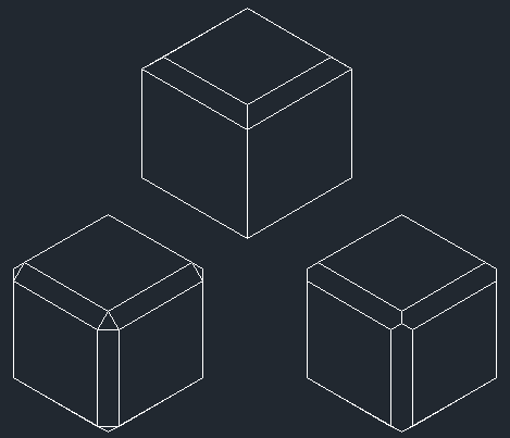

steven-g Posted December 17, 2013 Posted December 17, 2013 In isometric view a chamfered edge will look odd, even though drawn correctly. Choose your pick, I think they all are misleading Quote
akarees8080 Posted December 17, 2013 Author Posted December 17, 2013 Nearly - need to chamfer the edge not the corner Quote
