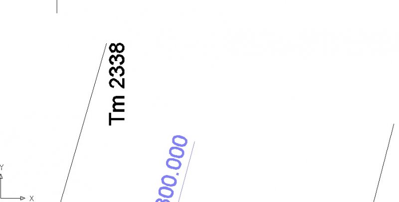

castagnaccio Posted December 17, 2013 Posted December 17, 2013 Hello, I'm wondering if there is a method to snap a text object to order to place it automatically parallel (therefore rotate) to the line on the left. please see attachment Thank you in advance Quote

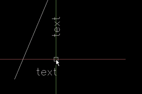

nestly Posted December 17, 2013 Posted December 17, 2013 For frequent use, one of the provided lisps would probably be best, but for infrequent use, Parallel and Perpendicular OSnaps might suffice. Quote

castagnaccio Posted December 17, 2013 Author Posted December 17, 2013 ReMark: thank you for your replay. That lisp doesn't work, the text does not get aligned. I think that the problem is that the orientation of the starting mtext is not 0 degree! eldon: thank you for your replay. The problem is that I don't draw the line before placing the mtext.. nestly: thank you for your replay. Your solution does work but only when the starting mtext is at 0 or 180 degree (perpendicular) or 90 or 270 degree (parallel). The starting orientation of the mtext is not 0 or 90 or 180 or 270 degree but random. Other ideas? Quote
eldon Posted December 17, 2013 Posted December 17, 2013 From the wording of your first post, one would assume that the line was there first. I find it easier to write the text first and then rotate it to align with an existing line. You could always set up a UCS parallel to the line, and then any text would align with the line. Quote
castagnaccio Posted December 17, 2013 Author Posted December 17, 2013 yes, the line is there first but I drew the lines all together and then I started to place all the text objects. The text objects were oriented not 0, 90, 180 or 270 deg. because I just copied a text object that was already aligned to a line. "I find it easier to write the text first and then rotate it to align with an existing line." Yes again, next time I will do the same . I solved this issue by selecting all the text objects at the same time and then setting the orientation to 0 degrees. After that I used the method suggested by nestly. I'm wondering if there is a method on how to point snap on a line that is parallel to the object it self, in this way I wouldn't need to rotate all to objects to 0 deg. Quote

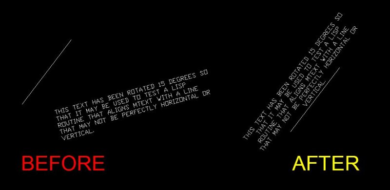

ReMark Posted December 19, 2013 Posted December 19, 2013 ReMark: thank you for your replay. That lisp doesn't work, the text does not get aligned. I think that the problem is that the orientation of the starting mtext is not 0 degree! Which routine are you referring to? The lisp routine I mention in post #6 works with MText as I just tested it. In my test drawing I had four lines of MText that were created with a rotation angle of 15 degrees and a single line that was drawn at an angle of 52.5 degrees. Quote
ReMark Posted December 19, 2013 Posted December 19, 2013 Aligned text test. Pay attention to the options Lee has so kindly provided as one of them is required to achieve the final result. Reference: Link to lisp routine in post #6. Quote
