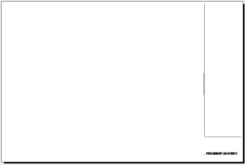

BudRPerry Posted December 16, 2013 Posted December 16, 2013 We have recently upgraded to 2014. Some of our plans created in 2011, when opened in 2014 have most of the objects missing in the paperspace tabs. This includes lines, polylines, blocks, ole objects, jpgs, and plain text. These are not xref'd items. A few members of our staff have LT 2014 and have opened these same drawings with the same error. We can recover using 2011, but if we recover the drawings in 2014 it won't allow us to save! Been searching the forums and net but can't find this exact problem. It's very frustrating! Quote

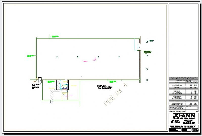

BudRPerry Posted December 27, 2013 Author Posted December 27, 2013 The errors haven't happened with a "start from scratch" 2014 drawing, they've all been with files created in earlier versions. I will try the repair once my IT guy is back from the holidays. The attachments show a before and after version. In the after version only parts of the drawing are missing including the jpg logo, some regular text, the vport, etc. Quote
