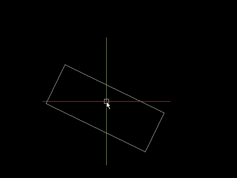

OrangeFu Posted December 14, 2013 Posted December 14, 2013 So! Here's the question I pose to you... Is there a quick way of achieving the following: You have an object rotated at an arbitrary angle You want to rotate it back to a 90 degree line by snapping it. I can do this by measuring the arbitrary angle and then rotating it manually based on my measurement. But surely somebody knows a clever way around snapping it back to an ortho angle! There's always a lazier way. Quote
mikekmx Posted December 14, 2013 Posted December 14, 2013 'rotate', 'reference' (look at the command line) what you want? Quote
eldon Posted December 14, 2013 Posted December 14, 2013 If you have Ortho on, then with the Reference option it will align. There is no need to measure the angle. Quote

Dana W Posted December 14, 2013 Posted December 14, 2013 If you have Ortho on, then with the Reference option it will align. There is no need to measure the angle. I just tried this one. With ortho mode on, it will not allow me any options other than rotation angle. Barring an angle, I can only rotate the object in 90 deg increments relative to its original position. Quote
eldon Posted December 14, 2013 Posted December 14, 2013 You are not using the command in the proper fashion. You first of all, using Osnaps, define the original reference line, then the required alignment is automatic with Ortho on. Quote
ReMark Posted December 14, 2013 Posted December 14, 2013 Are we throwing out multiple options because I have one that does not have the word rotation associated with it. Use the ALIGN command. When AutoCAD prompts, Scale objects based on alignment points? [Yes/No] : you want to accept the default "No". Quote
nestly Posted December 14, 2013 Posted December 14, 2013 Rotate > Reference using Polar (or Ortho) is how I would do it, although after setting the Reference angle, you could also just enter the new angle (ie 90) Quote
Dana W Posted December 14, 2013 Posted December 14, 2013 You are not using the command in the proper fashion. You first of all, using Osnaps, define the original reference line, then the required alignment is automatic with Ortho on.I see, Ortho must be OFF before starting the Rotate command, then I have to wait until I have entered the "R" option, then select the original angle, then turn on Ortho, then complete the rotation. I completed it by using "Points". Got it to work, but it is a little bit inconvenient. You take what you can get, I guess. No wonder I have avoided that for 10 years or so.. Truth is, the need only occurs about once every leap year for me, so apparently I have not learned its use sufficiently. Since in Drafting settings, I keep my Polar Angle Measurement set to Relative To Last Segment, I usually just rely on either a quick angle calc or an angular dimension and simply enter my rotation angle. What worries me is, I can't repeat the success I had with my first posted suggestion without erasing the original rectangle and starting over. I don't know what is up with that. It works the first time, and that is it. It could be conflicting with my Relative to Last segment option being set. Quote

eldon Posted December 14, 2013 Posted December 14, 2013 Ortho can be on, as long as you define the initial angle using Osnaps. Quote
Dana W Posted December 14, 2013 Posted December 14, 2013 Ortho can be on, as long as you define the initial angle using Osnaps.Yep. Got it to work. Also, with ortho on, one has to be careful about the order in which the snaps on the original angle line are selected. If I select the basepoint as the first point, then the top end of that same line as the second point, it works fine. If these same points are selected in the opposite order, the rectangle rotates to 180 instead of 90. Quote
OrangeFu Posted January 2, 2014 Author Posted January 2, 2014 Rotate > Reference using Polar (or Ortho) is how I would do it, although after setting the Reference angle, you could also just enter the new angle (ie 90) [ATTACH=CONFIG]45705[/ATTACH] Wow thank you! I learned something new today The .GIF is super helpful. Quote
