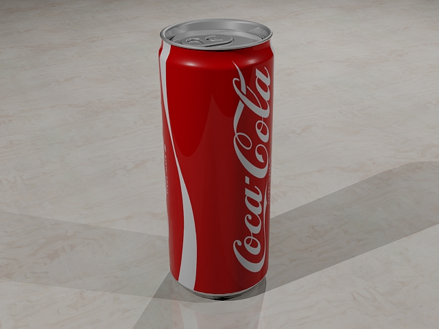

manumzo Posted December 15, 2013 Author Share Posted December 15, 2013 (edited) Here's a quick rendering under Autocad 2011 : " ...Ooh, I get high with a little help from my friends, Yes I get by with a little help from my friends, with a little help from my friends ..." coca cola can sleek.dwg Edited December 15, 2013 by manumzo Add DWG file Quote Link to comment Share on other sites More sharing options...

manumzo Posted December 15, 2013 Author Share Posted December 15, 2013 HI ReMark. Thanks for your compliments but I think you under estimate yourself. In fact, There's no particular difficulties in this object (You can take a look at the DWG I attached) Me, I don"t need anything more, you already helped me a lot ! Did you clean the snow ? Quote Link to comment Share on other sites More sharing options...

manumzo Posted December 15, 2013 Author Share Posted December 15, 2013 I definitely need more practice with materials and mapping them. Are you kidding ? you showed me how to do ... Finally, I think Autodesk made a very good rendering engine. I'm surprised with the result and I did not trim the level too high. Are you only working in 2D at work ? Quote Link to comment Share on other sites More sharing options...

ReMark Posted December 16, 2013 Share Posted December 16, 2013 How did you decide where to place your lights? Quote Link to comment Share on other sites More sharing options...
manumzo Posted December 16, 2013 Author Share Posted December 16, 2013 It depends on wich object you want to light. Usually i put one light on the front left or right and a second light in the back. This time, for the cans, i put 2 front point lights and 1 point light back. I let default light on too. I trimed each point light to 0.1 - 0.2 intensity otherwise it's too sunny. That's it. On the other hand, i am really not a specialist to give some lessons ... I'm sure there are some people here more able to give better techniques of lighting. Quote Link to comment Share on other sites More sharing options...
ReMark Posted December 16, 2013 Share Posted December 16, 2013 You're more of a specialist than I am. Is lighting easier to do in 3ds Max? Quote Link to comment Share on other sites More sharing options...
manumzo Posted December 16, 2013 Author Share Posted December 16, 2013 Yes, they quite simplify things. There's a light called "dome" which is easy to place. That's the light on the robot. Quote Link to comment Share on other sites More sharing options...
