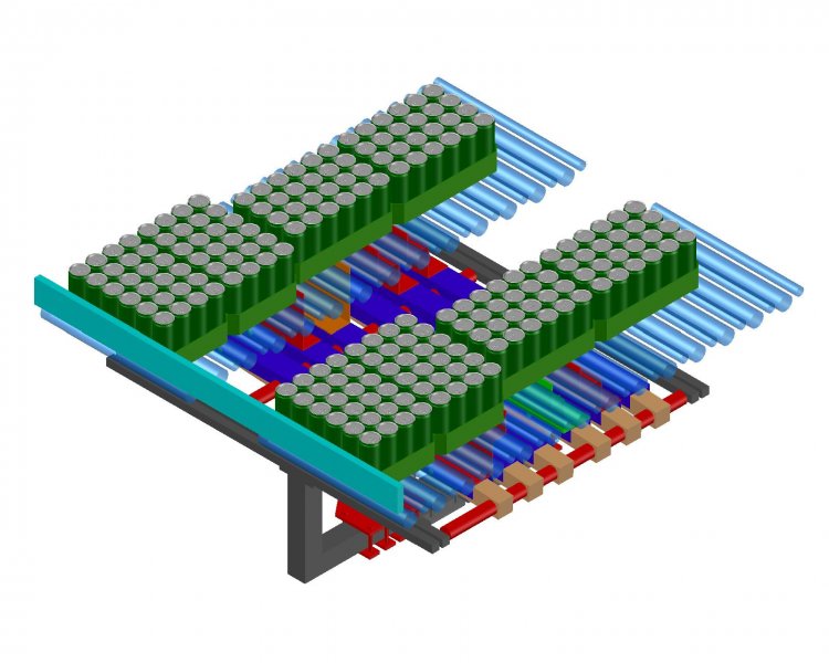

manumzo Posted December 13, 2013 Author Share Posted December 13, 2013 Here is the machine I'm working on and the F... cans ! Quote Link to comment Share on other sites More sharing options...
ReMark Posted December 14, 2013 Share Posted December 14, 2013 I see you were busy after I logged off last night. Thanks for the additional information. After doing some errands this morning (Saturday) I might have a chance to download your files and take a shot at wrapping the label. Quote Link to comment Share on other sites More sharing options...

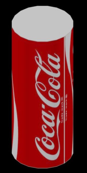

ReMark Posted December 14, 2013 Share Posted December 14, 2013 How does this image look? It's a first for me in a number of ways. Now for confession time. I did it using AutoCAD 2010 because I failed upon my first attempt to do it in 2013. Both programs work quite differently and if it wasn't for David Cohen's video I might have gotten totally lost on where to find what I needed and what to do. Would you like a copy of the drawing? In the meantime, after I have fortified myself with some lunch, I will attempt to duplicate the feat using 2013. BTW...the snow, which started early this morning (around 5:30 a.m.) is slowly but steadily coming down outside my office window. The weather reports say we won't see a heavier snowfall until this evening lasting perhaps into late morning on Sunday. I hope your weather is better. I hate winter. Quote Link to comment Share on other sites More sharing options...
manumzo Posted December 14, 2013 Author Share Posted December 14, 2013 You're the best ! Yes ! yes ! yes ! I want a copy of the DWG ! You did it with Autocad 2010. I just don"t understand why they have broken this feat in the 2011 - 2012 - 2013 and 2014 versions (I tried the last one version too without success...) Incredible. And no one noticed it, and complain about this ?... I have a contact at Autodesk. I'll ask him the question. I' m very grateful for your help and interest, you are "The best free help for Autocad on the web" indeed ! I'm always amazed by internet : someone near New York found a solution and helped me to solve my problem. That 's just incredible too, the magic of internet. Here the weather is almost fine (13-14 °C in the day), come to france ! Quote Link to comment Share on other sites More sharing options...

ReMark Posted December 14, 2013 Share Posted December 14, 2013 (edited) I think I just accomplished the task in AutoCAD 2013. However, I'm not exactly sure I can explain how I did it. It definitely did not look like this in the beginning. And to think, yesterday I had no clue! Thanks for making me challenge myself manumzo. I've learned something new which means I haven't wasted this day after all. BTW....that is not a rendered image. It is what the can looks like using a Realistic visual style. If you would like a copy of this drawing I'd be happy to attach it to a future post. Just say the word. Edited December 14, 2013 by ReMark Quote Link to comment Share on other sites More sharing options...

manumzo Posted December 14, 2013 Author Share Posted December 14, 2013 I am not at home right now. I just saw on my phone you accomplished the task successfully ! you're my master man ! i go back home in a hour, i can't wait to test the coordinates you entered (1 and 145 for the label) It's seems to be the right thing to do when i look at your screenshot. Respect ... Quote Link to comment Share on other sites More sharing options...
ReMark Posted December 14, 2013 Share Posted December 14, 2013 Note that 1 is the width while 145 is the height. I think the change in appearance came when I changed the mapping to cylindrical which was basically the last thing I did. Seems counterintuitive not setting this first. I think the 2013 can looks better than the one produced with 2010. What do you think? Quote Link to comment Share on other sites More sharing options...
