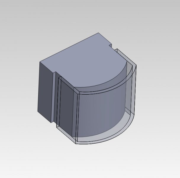

Sorry if I'm using the wrong terms, but I made a picture of what I'm trying to do:
I have a body, and I'd like to "peel" some of it for a given thickness. I could use the split parts feature, but what would be the best way to create a surface inside the main body, with an offset to some of its faces ? Ideally I'd like to:
- Create a 3D surface projected onto the main body
- Offsetting it so it intersects it
- Split parts
I'm beginning SW :)

I am using SW 2011. The part I'm most uncertain about is how to create the surface so it splits the solid at a given offset. In the given example, I could manually create the surface by extruding 3 times, but I wonder if there is a more general approach ?
I'll post an example of my specific case later today. Thanks again.

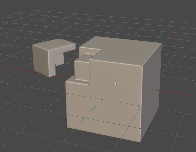

Ok, I found one way which I find a bit convoluted, but is there a better way ? I've attached the file :)
My ultimate goal is to make a shell that snaps to the main body... Maybe ambitious for my level.

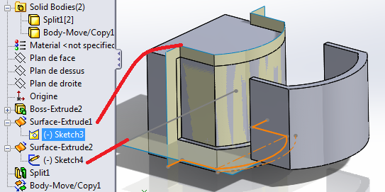

I can't remember how r2011 worked, but you might be doing too much work.
In the attached image I simply extruded a U shape for Surface-Extrude1, notice Sketch3 highlighted at bottom of the part
and extruded a line for Surface Extrude2.
Then I used the Split command. Notice that I did not have to trim the surfaces.
I tried to make the part more intesting with Surface-Extrude 2 is not at the bottom of the part, but rather, up some distance from the bottom more like your original image (the angle I captured the screen shot does not clearly show this).
In r2011 you might have to Trim the surfaces and then Knit them together before you can do the Split.Split Part.png
