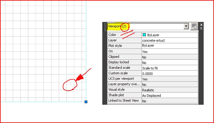

The model is still there. In Paperspace, Layout 1, in TOP view, if you zoom extents
you will find that there is an errant polyline from layer Floor 1,
which will be way down in the lower right hand corner of your screen. Turning off your GRID will help you to see it.
If you erase that, and Zoom Extents again, you will be back in the game.
I just realized that you have 2 viewports on top of each other in Layout 1, which isn't helping things any.
Erase one of them.

Did you read and understand that there are also two viewports, one on top of the other, as shown in the image?
Yes, i removed one
