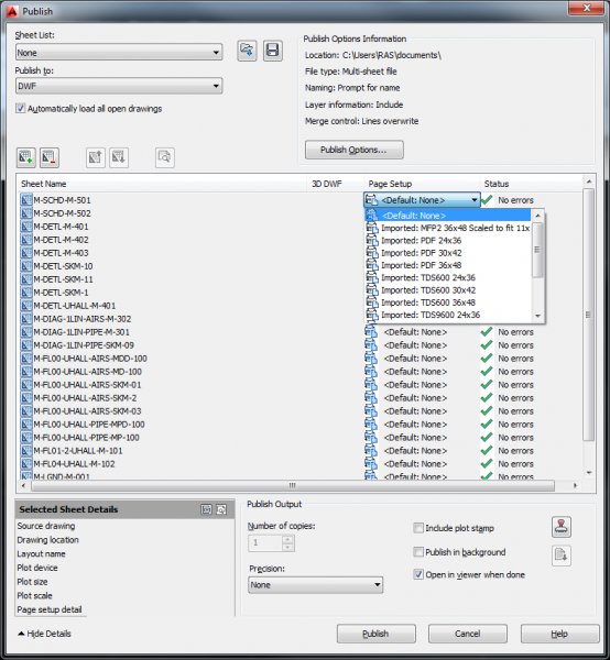

There's a caveat to the Publish command that you should be aware of. If you don't have all the Page Properties set for each layout tab, then you're going to have some troubles. Automation is a nice thing to use, but many time automating in AutoCAD means setting it up to use automation in the first place.
you could use RxHighlight from Rasterex. ww.rasterex.com. Can batch print and convert. No need to use an AutoCAD license either
If the Page Setups are not correct, a correct one can be imported and assigned to all from within the publish command. I keep a file with all of the page set ups that I need so I can import from it.
Import it to the top sheet, then select all to assign it to the rest all at once.
