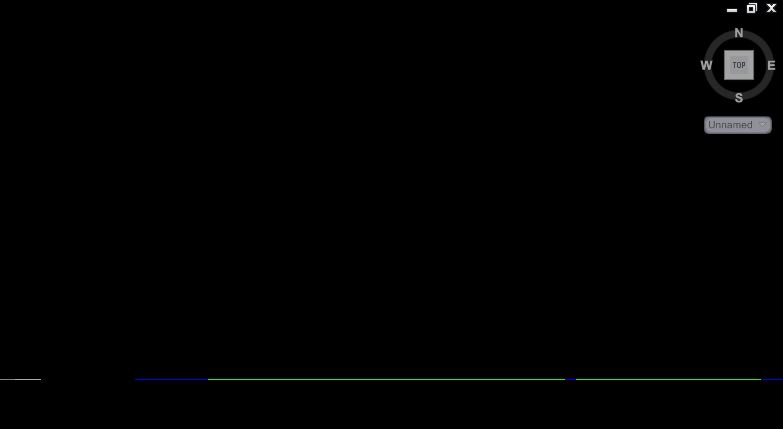

jcone Posted December 4, 2013 Share Posted December 4, 2013 I was working on tracing a fllorplan that was sent to me as a PDF last night and apperently I accidently clicked something and now everything I drew and the PDF and a few blocks I inserted are all on the front plane not the top. but if I try to draw a anything it is on the top plane. Please help Quote Link to comment Share on other sites More sharing options...
Dadgad Posted December 4, 2013 Share Posted December 4, 2013 Welcome to CADTutor. Try typing UCS at the commandline > ENTER WORLD > ENTER. That will probably get your world back on the tracks. Quote Link to comment Share on other sites More sharing options...
jcone Posted December 4, 2013 Author Share Posted December 4, 2013 The UCS is set to world but all of everything that I have drawn so far in on the front plane instead of the top plane where it was when I started. Even if I am viewing everthing fron the front plane if I draw anything it will be on the top plane. It is as if i rotated everything 90 along the X axis. Quote Link to comment Share on other sites More sharing options...
Gatekeeper101 Posted December 4, 2013 Share Posted December 4, 2013 The UCS is set to world but all of everything that I have drawn so far in on the front plane instead of the top plane where it was when I started. Even if I am viewing everthing fron the front plane if I draw anything it will be on the top plane. It is as if i rotated everything 90 along the X axis. did you change your view? type in view, the view manager appears, then select the preset views tree, followed by selecting the top view, afterwards select the "set current" button. now your view is set back to the top view. if possible could you attach a screen shot so we can see whats going on (Only if this does not fix the issue) Quote Link to comment Share on other sites More sharing options...
jcone Posted December 4, 2013 Author Share Posted December 4, 2013 No luck. Here is a screen shot from the top view. Here is a screen shot from the front view Quote Link to comment Share on other sites More sharing options...

ReMark Posted December 4, 2013 Share Posted December 4, 2013 That's it? All you wanted to do is rotate the floor plan so that when you were in the "top" view it appeared correctly? Here you go.... Test[ReMark].dwg Quote Link to comment Share on other sites More sharing options...
eldon Posted December 4, 2013 Share Posted December 4, 2013 Not knowing how ReMark's drawing was created, one way that ends up with everything at an elevation of zero, is to take the East or right view. Then rotate everything about the point 0,0 by minus 90 degrees. Saves getting tangled with 3D rotate. Quote Link to comment Share on other sites More sharing options...
ReMark Posted December 4, 2013 Share Posted December 4, 2013 I did not bring the floor plan down to an elevation of 0'-0". Is that a requirement too? OK....you got it. Test[ReMark_2].dwg Quote Link to comment Share on other sites More sharing options...
